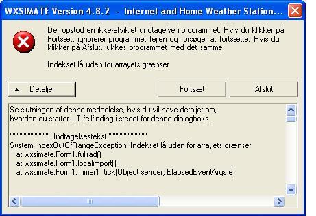

I keep getting error in wxsimate.exe with dot framework then “import data”.
Can you help?

Steffen,
I believe every time I’ve heard of this error it turned ou to be a bad line of data in the WD log file. It can be hard to find. You have to scroll down and see if something jumps out at you. Some other users have had exactly this experience.
If you can’t find it, post your March log file (32011lg.txt) and either I or someone else may be able to help you find it.
I found the problem, 1 line in the file was corrupted

Hi Tom
I get these errors several times a day.
Se attached.
