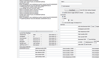

I can’t seem to get WD to recognize the solar sensor. The 1wirereader program says it a humidity sensor bust does not place it anywhere. My lightening sensor is listed correct though.
you need to copy the found humidity type ROM id to the solar sensor ROM ID
then click on save/reset
(do all this when WD is not running)

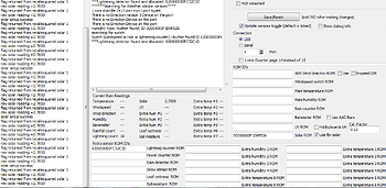

I turned on debug mode and I can see some values showing, however, I have not taken them outside yet.
Values are not showing on WD main screen.
I see a solar reading …
note that its a converted to wm/2 value
need to see your solar setup settings…for 1 wire and for max reading for lat/long
It appears to be working now. All I have to do is get WD to send the solar data to my website ( I hope ) :smiley:
There are some setup screens I have found for solar that I have used to get the graph on the main screen bottom graph. I hope these help.
