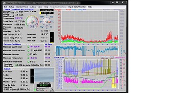

I have been using a Hobby Boards Hub. It would not find wind direction, I was getting humidity spikes.
After trying several hubs, all exhibiting the same problem, I now use a homechip.com JB6 junction box.
But I still have problems. Mainly that starting WD/dallas1wirereader it doesn’t always find all the modules.
One or more of the following is not found - solar, outdoor humidity, wind speed, rain gauge.
Exiting (Save and Exit) WD and restarting it, sometimes takes up to 10 attempts, before most devices are found.
Also, there are times when one or more readings gives a flat line and I have to restart WD/reader.
You will see the problems on my screen grab
It’s getting very frustrating.
