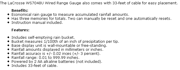

edit:
Doing a google search for the rain gauge I see several places that say it is .0105 per tip.

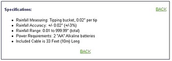

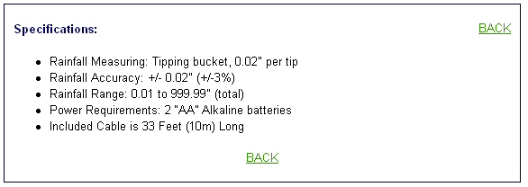

Hello,
Well I have just looked up the details from the LaCrosse web site and as you will see from below, a screen shot from the there website, it’s 0.02 per tip, however the rain full range is from 0.01 to 999.99. So if it’s 0.02 per tip, how can a range start at 0.01 !!!
a ha
i was correct all along, and aag has it wrong

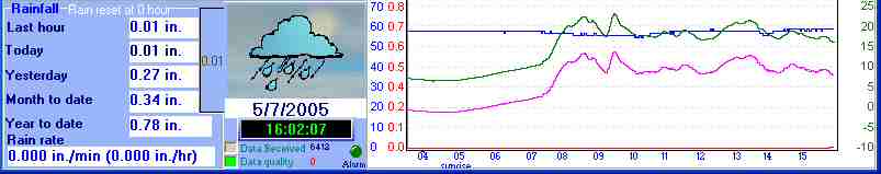

Hello,
But, what is odd, I’m sure, that when we had some rain, WD said 0.01 not 0.02 !

Which means WD is reporting it as 0.01 as you will be able to see from the attached screen shot. We had some rain today and it’s reported it as 0.01 which the device can not measure, as this device can only have a minumin measure of 0.02.

I have had more rain, and it looks to me if it’s incrumenting at 0.01" not 0.02"
