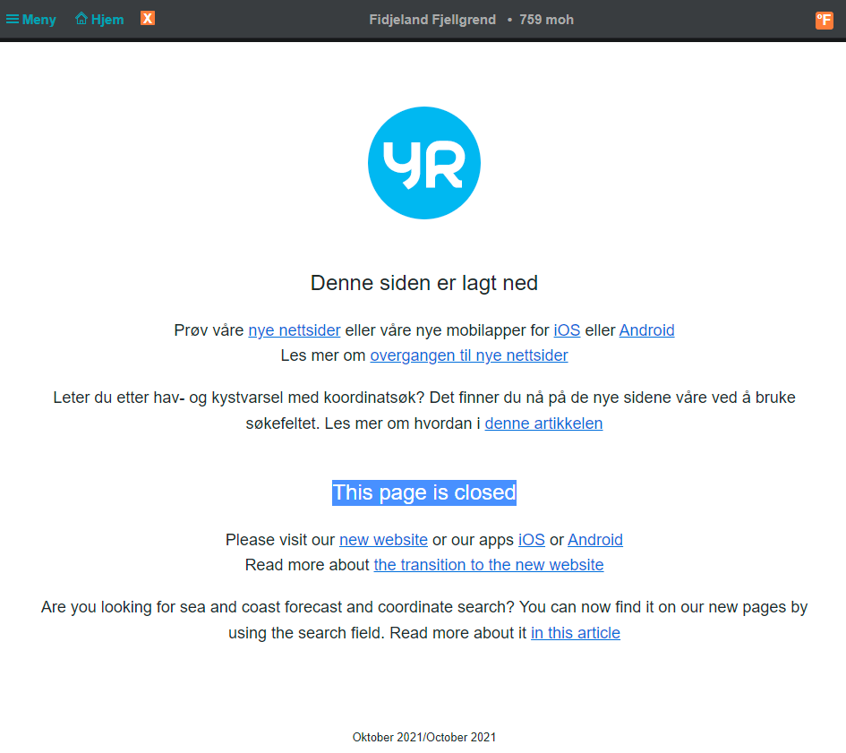

I get an error when I select full screen weather forecast from Yr - “This page is closed”
Landing page informs about hitting a legacy forecast that is no longer in use.
Should I just disable full page menu option under Weather forecast block or is there some updates that I’m missing?

Not at all
The page merly says that this page has been replaced by another solution.
This means that the script needs some changes.

But there are multiple references to this “solution” all scattered around , all with the same recipe for a solutioin.
Cause: Yr.No is/was gradually changing the old-link → temporary “retri”-link → new link with a city number.
These discussion and the latest version of PWS_frames.php have both the old retro and the number link as examples

The only change i can do, is remopve the link from the PWS_frames script, I doubt that is necessary.
As described, in all the posts, you yourself have to find that number.
