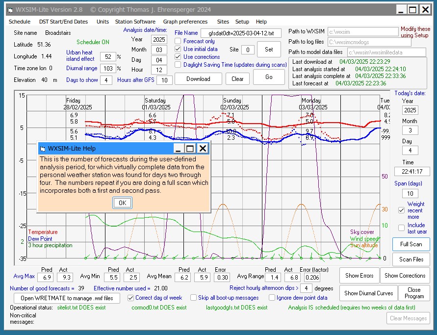

I just ran a full scan manually having set the number of span days to 10 and it used 39 good forecasts with an effective number of 21.00 which is about half of the 39 because I have set Weight Recent More. This was a two pass scan as it was a full scan.
I run 4 forecasts a day which gives me 40 forecasts in 10 days. Normally I currently use 70 for the span days value but that takes ages! The following image shows the help text for Number of good forecasts.

I thought I understood what the blue text told me until you said that you’re seeing 39 good forecasts. The help text suggests it’s the number of forecasts in days 2 through 4 (so 3 days) with good station data, so with 4 forecasts per day that should only ever reach 12.
If you see 39 then I don’t understand why I’m not seeing 24 when I’ve got 24 forecast files in wxsimlite directory? I’m not aware of any gaps in my station data this year so that’s not the reason for the low count.

Actually I just looked at my wxsmlitedata directory and counted on 39 forecasts for the10 days so it used all of them. For some reason I only had 3 forecast files for the 28th Feb!
These scans are using both the wxsimlitedata directory files and data from your station logs - in my case CumulusMX data files - and I assuming in your case WD log files so to do the scan it must find both sets of valid data for the day in question. I suspect it is also looking at the *.wxf files in the WXSim directory so I’m assuming it needs to match these with the wxsimlitedata files and your WD logs in order to do the analysis.
This days 2 through 4 part I think refers to the fact that there is that each forecast file contains about 7.5 days of data (mine go up to +180 hours) and so I think it uses days 2 3 and 4 out of each forecast.
