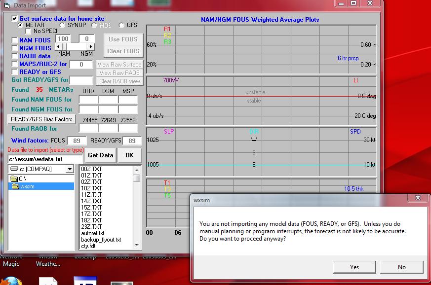

I just downloaded my this Beta this morning. It runs fine in Manual mode but I get the following error in Auto Mode
I am sure I probably just don’t have a correct box ticked?.
Brad
When I run in auto it finishes <30 sec. No error boxes.
In manual, I get to the data import screen (using FOUS, RAOB, READY/GFS). Then an info box when getting through Adv Data Entry states MOS has run out, the runtime error 62, ‘Input past end of File’.
Some answers …
‘Text box full’ just means that the 32K limit of the output screen has been exceeded. Nothing is lost in the saved forecast files. To keep the message from appearing, you can just increase the output interval (under Parameters) say, from 30 minutes to 1 hour.
If you get a message that no FOUS, READY, or GFS was used, that means you need to tell WXSIM to use it. In Auto Run mode, that’s done by checking the appropriate boxes on the Auto Run form under Start.

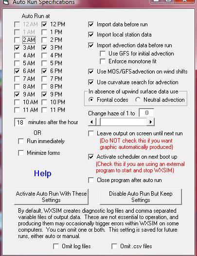

Tom atatched is my setup for auto run
If I mark “use GFS for initial advection” I get a runtime62 error everytime I try a full start

OK, idea #2! It’s likely then that on your Import form, somehow READY/GFS and FOUS have gotten unchecked (I don’t know how it would have happened). In manual mode (disable auto run for a bit), go to Import, and make sure the METAR, NAM FOUS, RAOB, and READY/GFS boxes are checked.
Let me know what you find.
