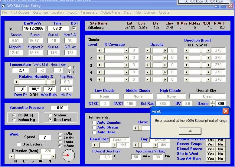

When i want to open my saved forecasts in WXSIM i get an error - see attached screen dump.
I have tried to reinstall the upgrade from WXSIM.com and of course tried to reboot my PC many times.
Problem solved
Im running Windows Scheduler and has the program set to terminate WXSIM after a forecast run.
I have figured out, that you have to press the quit button instead of terminating the program if you have ticked “archive” to save a datestamped forecast file.
HI that neat; & exactly the problem the problem I had. #-o & when you think about it pretty obvious trouble is we alway blame the software! nice one :lol: KRAC2
