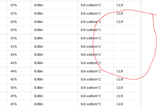

Well, without changing anything, I saw something different tonight. I guess reporting “CLR” reset something because anything other than “CLR” is not reported now.
Anyone else having this problem? or have I misconfigured something? :?
I have seen this before with something like cloudy or partly cloudy not being received or interpreted. Last night I’m not sure what the conditions were through the night but just a few times it showed CLR but mostly blank.

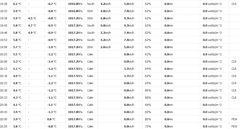

There seems to be an issue with “Mostly Clear” or another? as it draws a blank too. Most other conditions are now recorded - see the second image. I updated WD at 6:38pm. I think the same condition is missed at daytime as well.

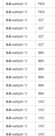

I recorded “CLR” and “FEW” last night, which seems to be working. Hopefully, we will have a chance tommorrow night to see “SCT”,“BKN” and “OVC” RAIN!

I forced the values on the thresholds and got all 5 conditions. It seems to be working for me.

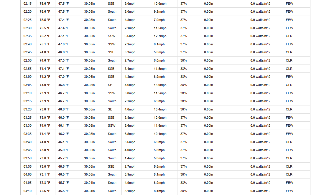

I’m sure the nighttime cloud sensor sky conditions tags were working correctly for me last night. All the lines were filled in byu the end and all conditioons indicated too.
