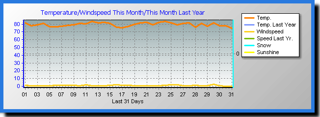

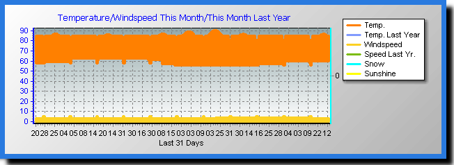

The day numbers on the windtempraintrend3d graphic are all over the place. See first attached pictures.
Also, is there any way to change this back like it used to be, i.e. the 2nd picture?

Did as you suggested, and the numbers did change, but their still all wrong. I can’t see any problem with my data looking at anything else.
See new picture.
