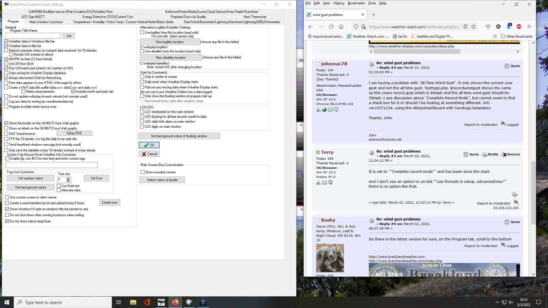

re freezing up, try unticking to use threads in setup, advanced/misc
I am having a problem with “All Time Wind Gust”. It only shows the current year gust and not the all time gust. Testtags.php. $recordwindgust shows the same as this years record gust which is 40mph and the all time wind gust should be 58mph. I see discussion about “Complete Record Mode”, but cannot seem to find a check box for it or should I be looking at something different. WD - ver1037s134. using the AltAjaxDashboard with Saratoga templates.
Thanks, John
It is set to ““Complete record mode”” and has been since the start.
And I don’t see an option to un-tick ““use threads in setup, advanced/misc”” there is no option like that.
Its there in the latest version for sure, on the Program tab, scroll to the bottom
If tit’s there then I’m blind, don’t see that option anywhere…Running version 10.37 S134
Thats why i said “in the latest version” :wink:

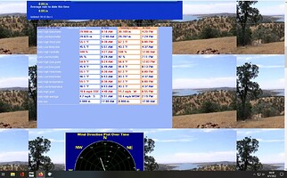

Still having the wind gust problem and the “program not responding” problems, also a new problem popped up this morning, the main display for WD on the PC was like this …
All blue with the header and a small square at the top left.
So I downloaded a fresh install file of WD, and it cleared up, all back to normal, will have to wait to see if the wind gust problems have gone away.

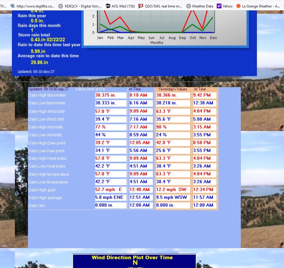

OK, this morning the wind gust was reported as 65.7 MPH at 02:36 3/30/22, checking the weather instrument data history, at that time and date the high wind gust was 6.57 MPH…So at random times WD is misplacing the decimal point one place to the right…Weird problem, the data line from the weather instrument to the computer is a shielded RS 232 cable…

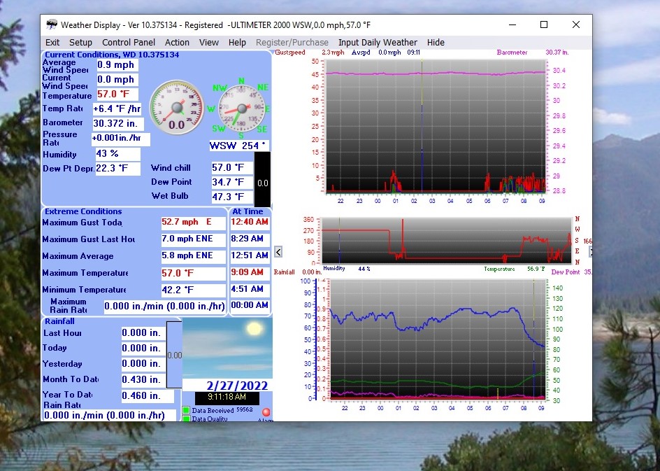

It did it again, this time I got a screen shot…Decimal point one step to the right.
OK, I’m getting a bit frustrated having to correct the wind gusts almost every day, (still being reported over 75 to 90 MPH) it looks to happen only at night, around 2 to 4 AM, now looking back at the data on the Ultimeter it shows ether zero wind at those times or very little, (under 5 MPH) is there a way to shut off only the wind gusts being reported in the “Daily high wind gusts”???
