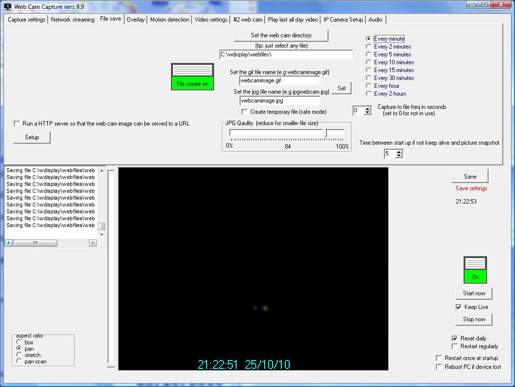

post a screen shot of your file saving settings
image of file save settings
do you have the 2nd web cam in file save in use at all?
