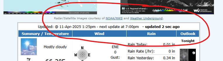

In your testtags.php the time of next update is empty.

$timeofnextupdate =  '---';	// Time of next Update/Upload of the weather data to your web page (based on the web table update

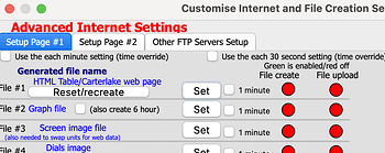

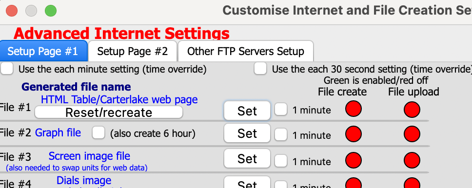

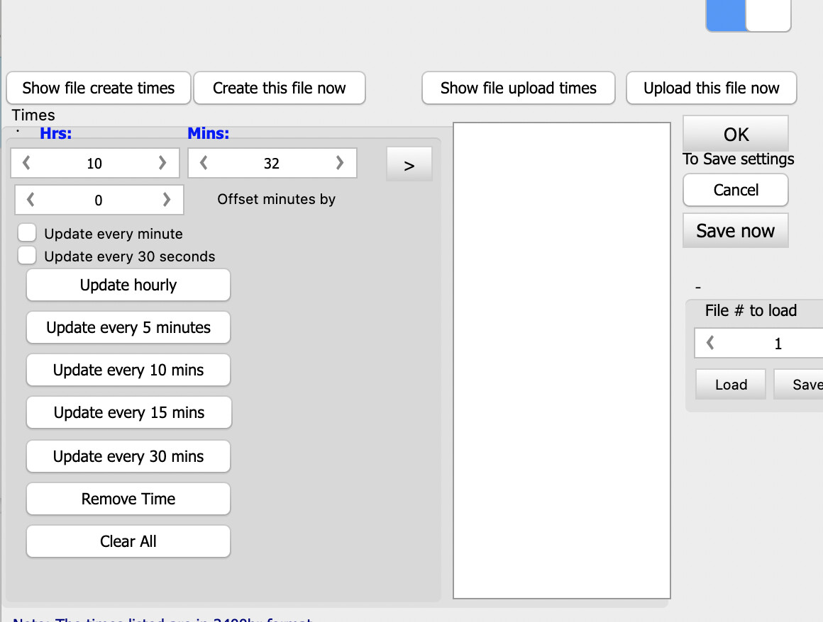

This is set by the “Internet and File Creation Setup” item #1. Check the file create times there without regard to how often it get uploaded.
Jim
THanks, this is nothing I would have changed. However, confirming this is what you mean? If so how do I change this to every 10 seconds - the earliest is 5 minutes. I thought the 10 second interval got set somewhere else.

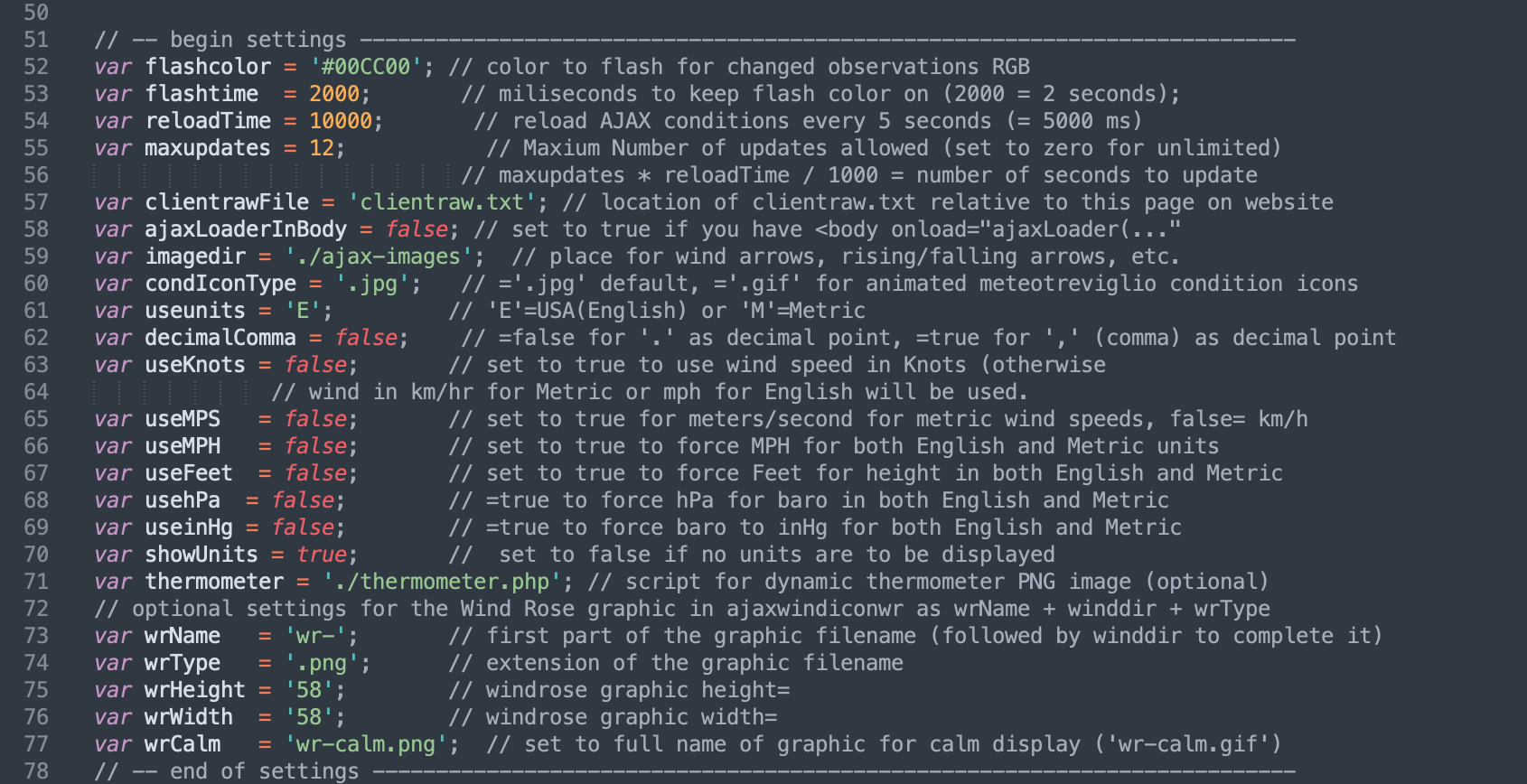

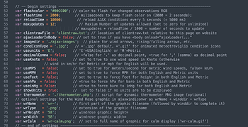

In the ajaxWD file here is a screenshot of the lines mentioned
how did line 57 get changed?
The others Im guessing make sure they look like this?
SORRY guys.. not the greatest at this.
When I look at the ajaxwd file on the carterlake site lines 57-78 are the same. So i’m not sure what to change

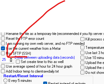

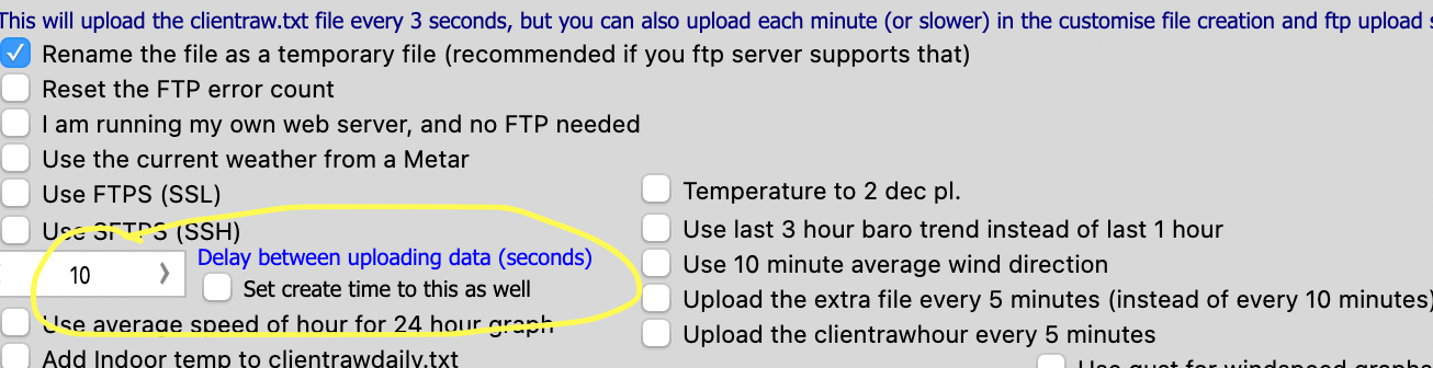

Yes, that sets the time of the testtags.php next upload. clientraw upload time is in Control Panel->Web Files/Web Page Setup->Real time clientraw upload.
Jim
Thanks, I had to find that in the mac version (which is radically different). Having said that it is set to 10 seconds.

The line 57 would only need changing if the clientraw and Ajax files were not in the same folders in your case they are all in the root folder so the line 57 can be left as is

You are updating now but this too will be fixed if you fix that which is shown above.
Jim
P.S. 5 minutes is fine for that one.
