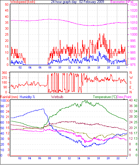

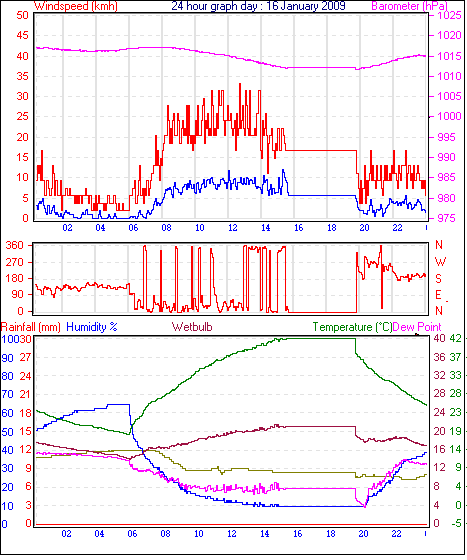

The pic is a look at where the temp leveled out at 42.1, the graph appears to only go this high, will the update fix this? today may get as high 8O do I just shut down WD and install update and it will take care of it’s self or is there something else I have to do
all the data has flat lined…
what is the indoor temperature when that occurs? (on the console)
Indoor at the time was around 30, only seems to happen when above 41, as mentioned the same happened on Sunday last week at 41.3, on Friday max Temp was shown as 42.2 but the flatline was 42.1, when the LCD showed less than 42 then WD started to show the correct Temp (as was shown on LCD screen), I haven’t as yet installed the download mentioned above, are you saying this won’t help?
