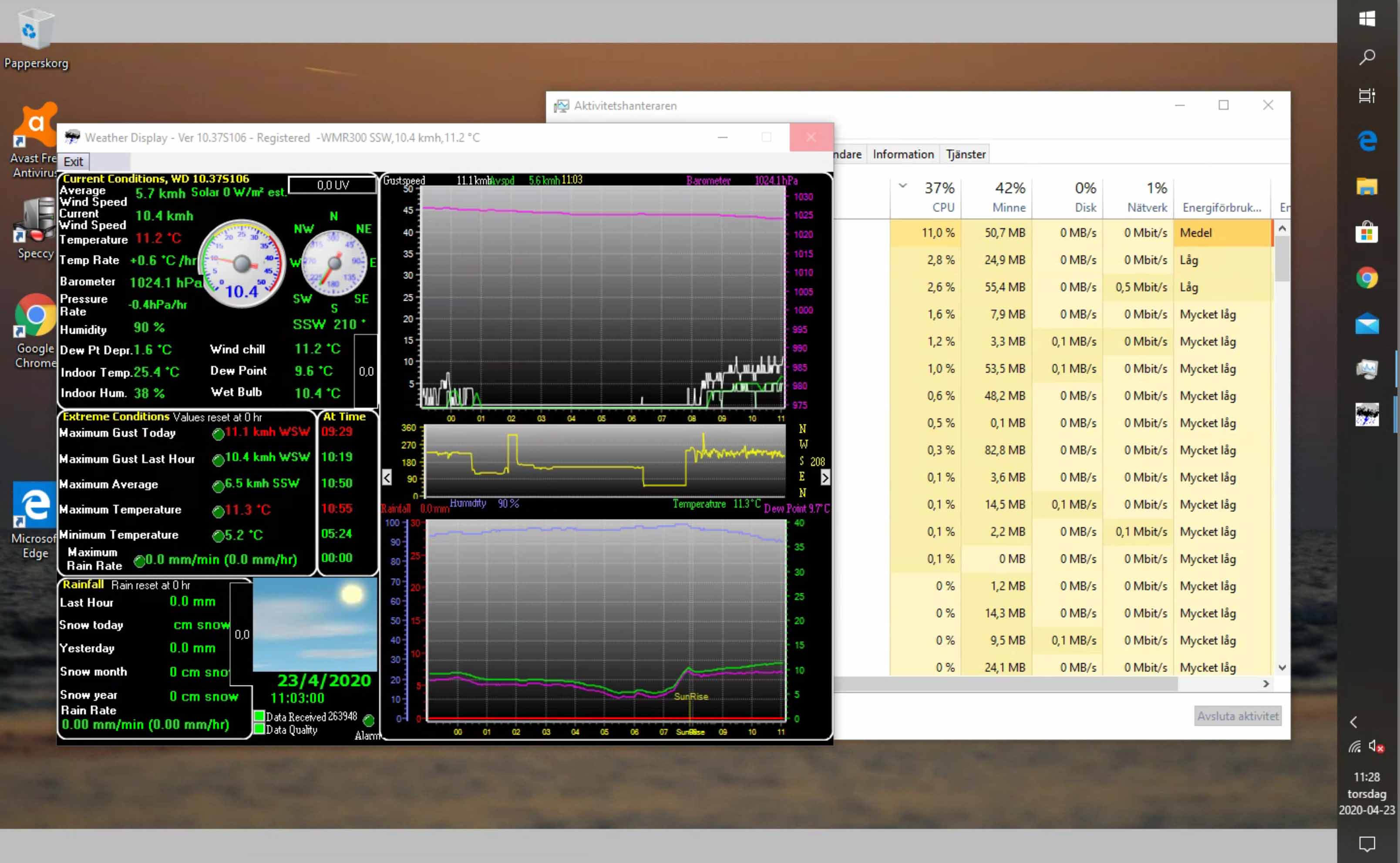

Here finally I have a screen shot.
As you can see only exit remains in the menus. To the right, in the you can see that there seemingly are two windows open in WD. I guess the second one is a dialog box that is behind the main program.
WD seems to be in a cycle where it is performing some action again and again, causing the menus to appear and disappear again and again. The program is unresponsive. In some instances there is no other way to shut it down, than to restart the computer, at other times I can click the red X to close the program down.
You can also see from the screen shot, that the program stopped recording readings a few minutes after 11:00, while the computer time is at 11:28.

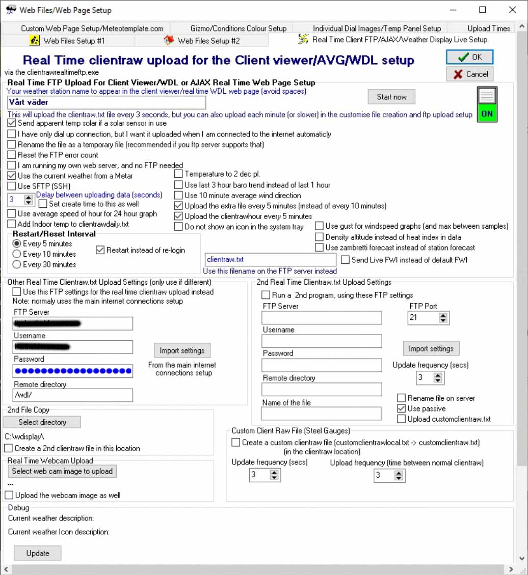

Here is a screen shot of the web page setup.
As I suspect you’ve had these settings for some time it’s probably unrelated but the weather station name field says to avoid spaces and your name contains a space.
Are you able to display the hidden page by using Alt+Tab to switch to it? If so you might get a better view of what’s causing the hangup.
i have not see the problem of the menu items disappearing before…that is a new one
might be some problem with the memory or graphics driver
Chris - I have changed the name from Swedish “VÃ¥rt väder” to English “Our_weather” without the space. The Swedish extra characters do not always agree with systems in English.
