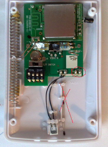

Have a look here: http://discourse.weather-watch.com/p/305267
In the attachment you’ll find a photo. Replace the temp bead marked with a red X. Then connect your new config at the two pins marked with a curl.
Also there is the English manual for the light probe.
