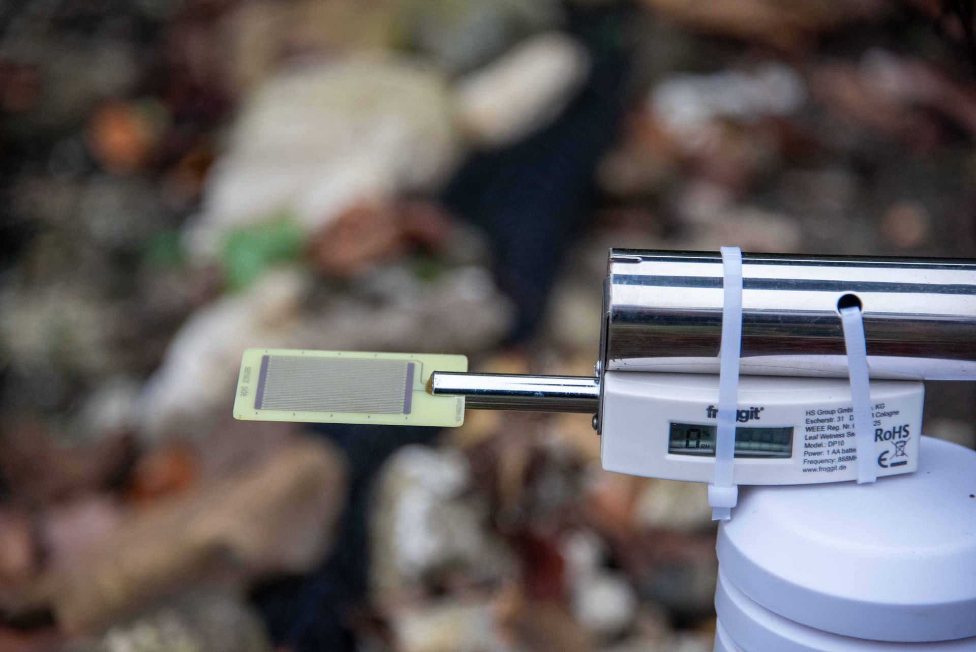

The only thing that can be added is the leaf wetness, this only gives the humidity percentage in percentage.
I would like to have that added but I can’t find a setting for this.
It is shown in the rain-block if it is more relevant than f.i. snow
Field description “Blad vocht” in Dutch
In your ecowit upload file its value is
    [leafwetness_ch1] => 0
Never seen that low when it is raining.
See also Leaf wetness - Wikipedia
Should show a value up to 100% wetness when it is raining.
Thank you Wim, this is my leaf wetness sensor…
