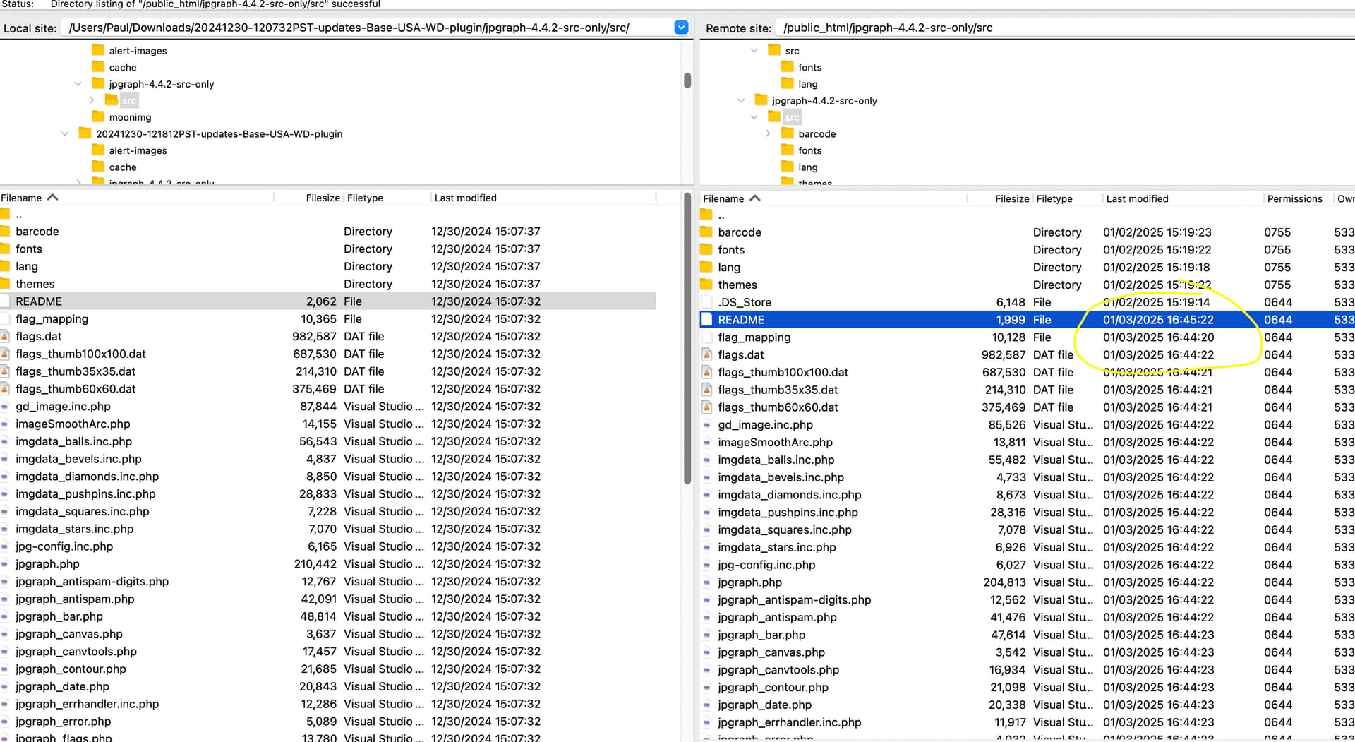

Ok… .I copied the entire Jpgraph-4.4.2-src-only from the zip file I downloaded
Screenshot: Left is from zip file right is whats their now. Now that I look the file sizes dont match. I could try again copy everything from src folder in the zip over to my host site?

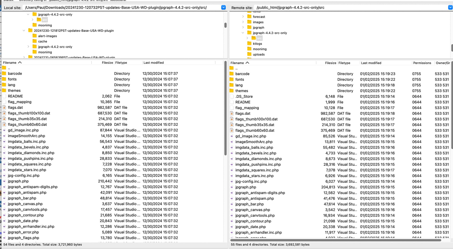

I copied the /src from zip over to host site (few times even). Host site now shows a date of today. However the file sizes dont match in all.
I still get the error
