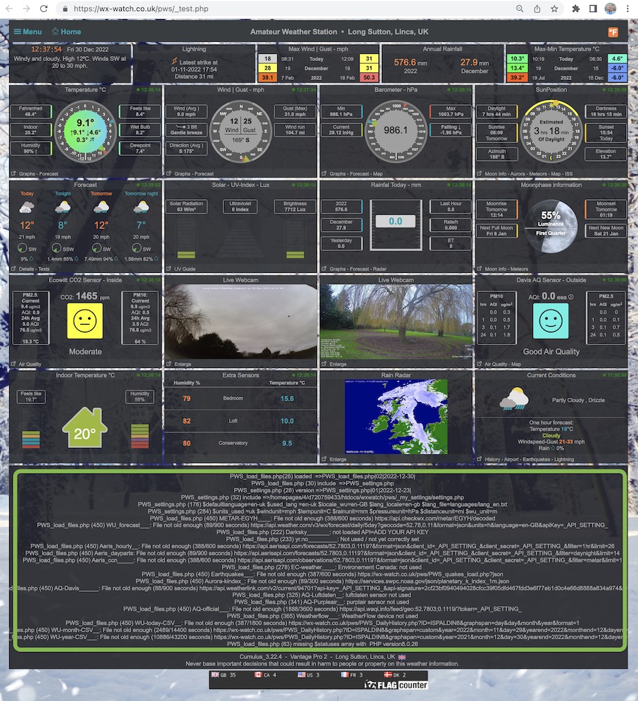

The messages in the footer (=area below the blocks) are debug messages we need to check if there are errors / invalid data.
They are printed because we asked for those messages by using _test.php
Succes, Wim
Succes, Wim
Not a PHP 8.1.13 problem.
It seems to be a local situation and for that I can not do anything without FTP access to the user server.
Yes, that message means that it is not a PHP 8.1.13 problem. It is a problem with your local situation.
Every version of PHP 8 will throw the error from your fist post.
Can be caused by anything: scripts, adaptions, combination of resources, whatsoever.
No way I can test this without full FTP access.
But my agenda is fully “locked” until January 19. And most of the time I am without decent internet also until that date.
As long as you use the adapted load-files script your website can run without errors on any PHP version.

Found out the errors using ?test and have corrected these and the site is now running PHP8.0
