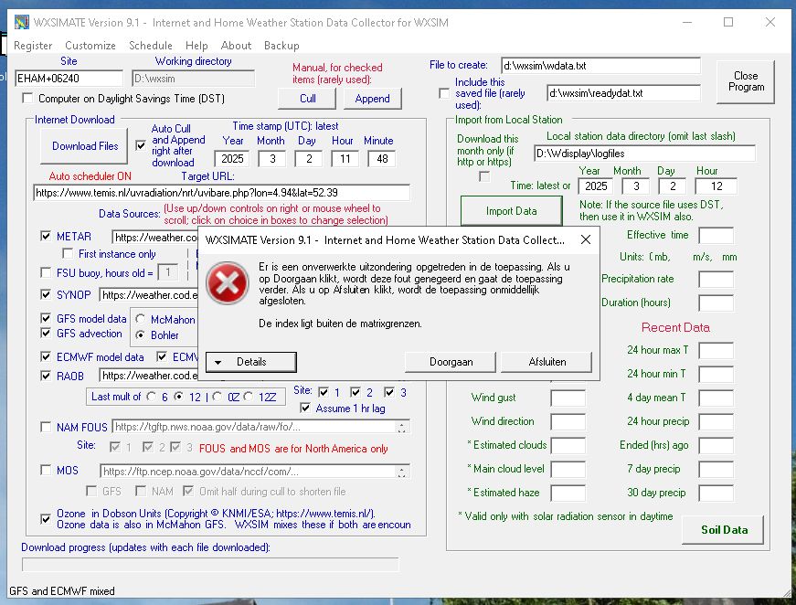

but now when trying loading files from WDisplay logfiles, this error:
System.IndexOutOfRangeException:
The index is outside the matrix boundaries.
Tried latest update WXsim same error
