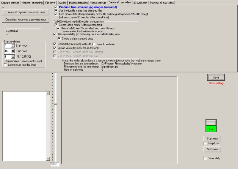

Now that is strange. I viewed the wmv file you created here and it looked ok so that rules out my player. I will take some screen grabs to show how I set things up here. It did take me a while to get the timestamped images to be produced, but I am still getting double saves, one with jpgwebcam.jpg as the file name and the other with jpgweb2cam.jpg. Not sure why it’s doing that, obviously I have something not set right. I had a hard time getting the correct filename and location set in the setup screens so I may have missed one somewhere. I think the animated webcam settings are messing me up.

I am still having problems with this, I don’t know exactly what I did but the videolastday.mpg is producing every hour, but the lastday.wmv & yesterday.wmv are not :?
Just one other thing, should there be a finish.txt file in wdisplay folder? At the moment there is not.
If there should be I don’t have one also.
