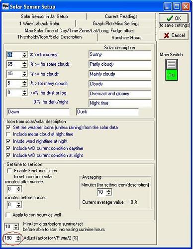

You will need to add an offset to get VP calculations more realistic. See screen shot.

I can’t find the settings page in your screenshot … perhaps it’s only in the bought version?
