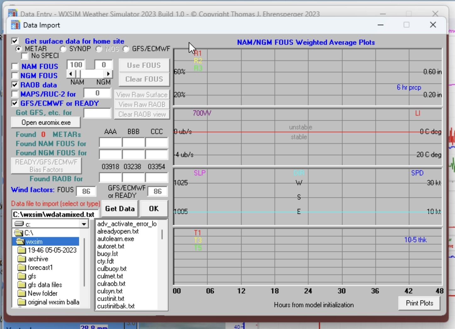

In addressing reporting problems from a couple of users, I’ve run across two issues that are worth checking on. One is that it’s not been clear to many people that, to use the relatively new euromix output (mixed GFS and ECMWF data), you will likely need to change the name of the file to import into WXSIM. In the past, I’d generally set users up with wdata.txt as the default export file from WXSIMATE, and as the file to import (under Import/Import Data, accessible once you temporarily disable auto run). With euromix.exe, though, it has to ingest one file name and output another. My default now is to continue with wdata.txt as the output from WXSIMATE, but then have euromix import that and output wdatamixed.txt, when then becomes the name of the file you should be ingesting into WXSIM. I’ve seen in mutiple users’ iitialization files that they (understandably) didn’t get the message to change the name in WXSIM form wdata.txt to wdatamixed.txt. The result would not necessariyl be “bad” forecasts, but it would fail to take advantage of the improvement available with the new, ECMWF “enriched” data.

I had not change this till yesterday as I did not know about changing it
I see there is a RAOB check box there as well be have left that as was not seeing any strange gusts
