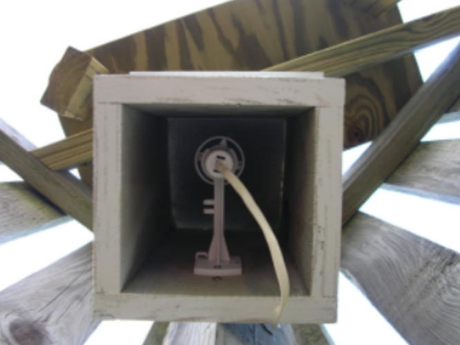

I just made a new sensor shelter for my thermo/hyrgro sensor (as seen in my other topic).
When I go with a passive shelter I prefer more airflow through the shield. What if you cut some angled slits into the side panels similar to that of house shutters? Improved airflow, greater temp response, yet still blocking the sun’s radiation.

I think what NorCal and others are saying is that your shelter is not very efficient for keeping your thermo sensor accurate. Basically what you’re getting is a “bubble” of stagnate air in the bird house which is throwing your temps off.
Adding a fan will certainly help but also adding some holes to the top area of the box sides to let some current flow should at least help.
The clip-on variety of solar hat fan (which I have not tried but suggested as a low cost option) could easily be added with a small metal tongue on the end of the box. My concern would be how much sun that spot would be getting to power the fan. Also, at night, you will have the same problem as during the day, because as the fan grinds to a halt, a pocket of warm air will stay in the bird house.
Ideally, the stevenson shield should actually have two roofs and be very well ventilated to prevent stagnate air from building up.
In my case, I have my sensor up under an eave on the NE side of the house where no sun will ever hit it. My issue is similar to yours with a pocket of stagnate air, particularly on windless days. A powerful 12v computer fan mounted in a well-ventilated shelter does the trick on moving the air 24 hours a day.
I do have about 1/4" - 1/3" thick space that goes all around the top of the bird house (the spaces are underneath the roof of the bird house…you probably cannot see them because the roof comes out so far).
Although you may think that, my temperatures are just about dead on the temperatures that are recorded in my town.
