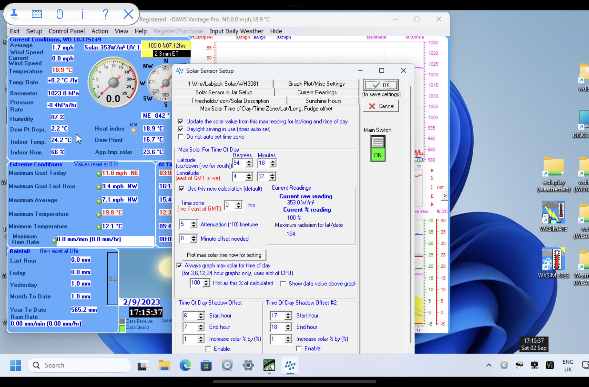

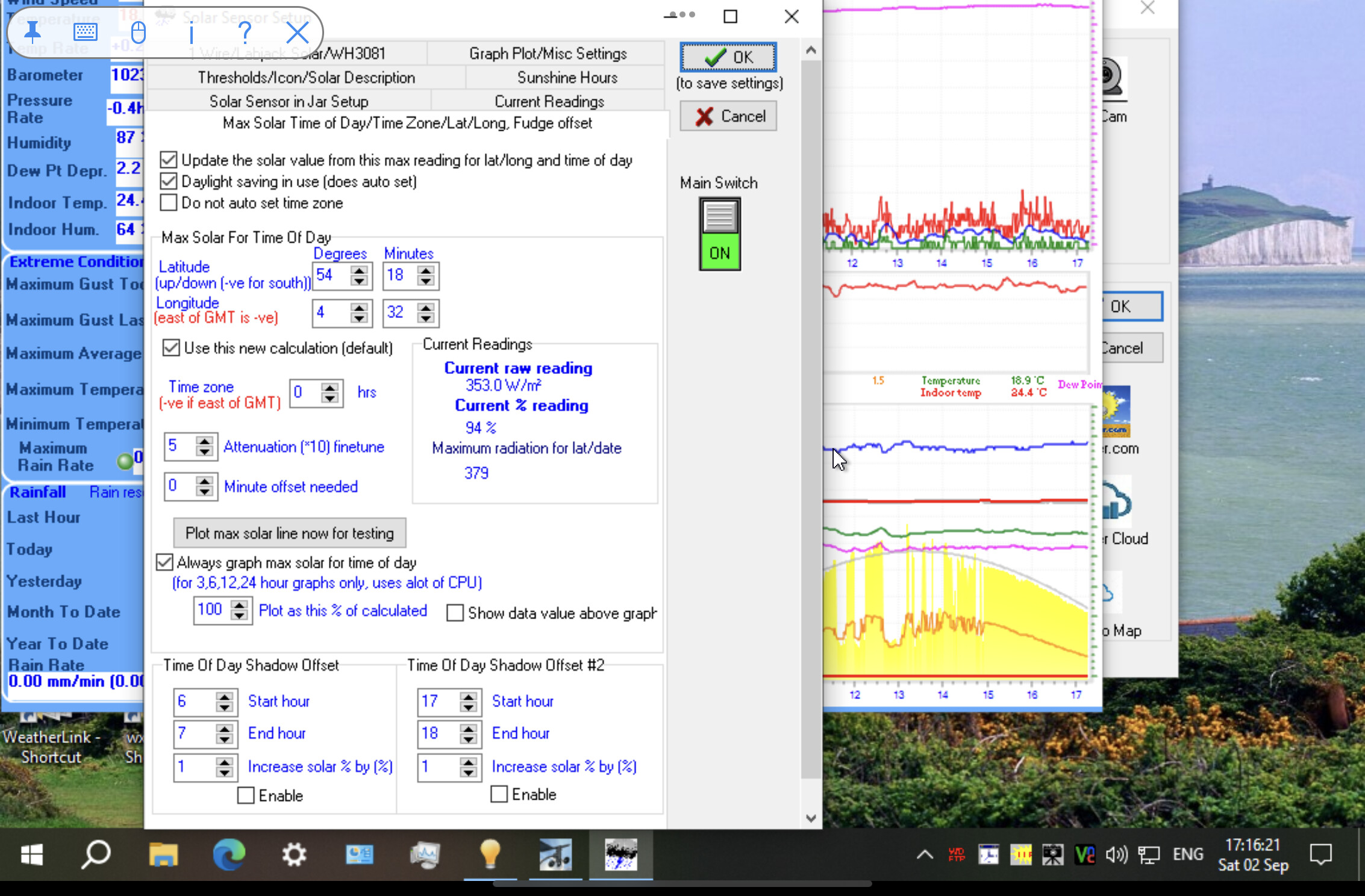

This is build 149
This is build 145
This one I consider correct
I have a feeling it was too high in the first part of the year now it’s too low
This is build 149
This is build 145
I just checked my solar values today as WD showed 10+ hours of sunshine and CumulusMX showed 0 and found that at peak time today WD had a maxsolarfortime value over 200w/m² lower than it should be which explains why the sunshine hours are so ridiculous. CumulusMX is actually correct as we had quite thick haze / cloud pretty much all day, we might have had a couple of minutes of sunshine . Bear in mind that both WD and CumulusMX get their actual solar w/m² values from the same sensor.
I really do not understand why Brian is not fixing this as the values are so completely wrong and vary widely across the year, sometimes too high and then too low.
So what I’m learning is build 146 is probably the best option or switch to Cumulus

Are you still using these settings?

I have reread this post.
My max solar expected is too low.
My weatherflow sky reads much higher values and thus creating % way over 100 and thus registering more sun hours.
I am running latest version of WD of November 13th.
Cronweatherflow 9.0
I am not at my controlpanel right now.
If it’s too low, you set + minutes?, not sure if you can go negative also?

If you go to https://www.stella-maris.org.uk/maxsolar1.phtml it displays the values for the location entered, it is using the code I supplied to Brian and until about v145 the WD code compared well to this. This site still compares well with CumulusMX values it creates.
