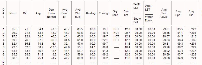

OK, I have it working auto now, with this .zip update (build 10):
http://www.weather-display.com/downloadfiles/WeatherD.zip
(and unzip the climatedata.html and climatedatayear.html files to your webfiles folder (or add to your customisation of those files) , as there is a fog days and gale days added)
the thresholds for setting snow or fog is what you have set in the summary image and icon setup, thresholds
if the temperature goes below -10oC i have put COLD, or if goes above 35oC I have put HOT
more than 50mm of rain for the day and i will say RAIN
(i guess i will need to make those user selectable thresholds)
the threshold for GALE is 10 minute average speed of 35 knots (38mph or so) or more
( i have 4 gale days last year :slight_smile: )
Anything but 1) !!! Metars are not accurate and lack details
I assume it will work with temp
i have now added it as user adjustable the settings for HOT COLD and RAIN
in build 10 .zip, ready now
(in the detailed climate section under view, averages/extremes :slight_smile:

maybe hot as hades as an option? ( not that I have been there , but I have know people that should have been there to report.) :oops:
