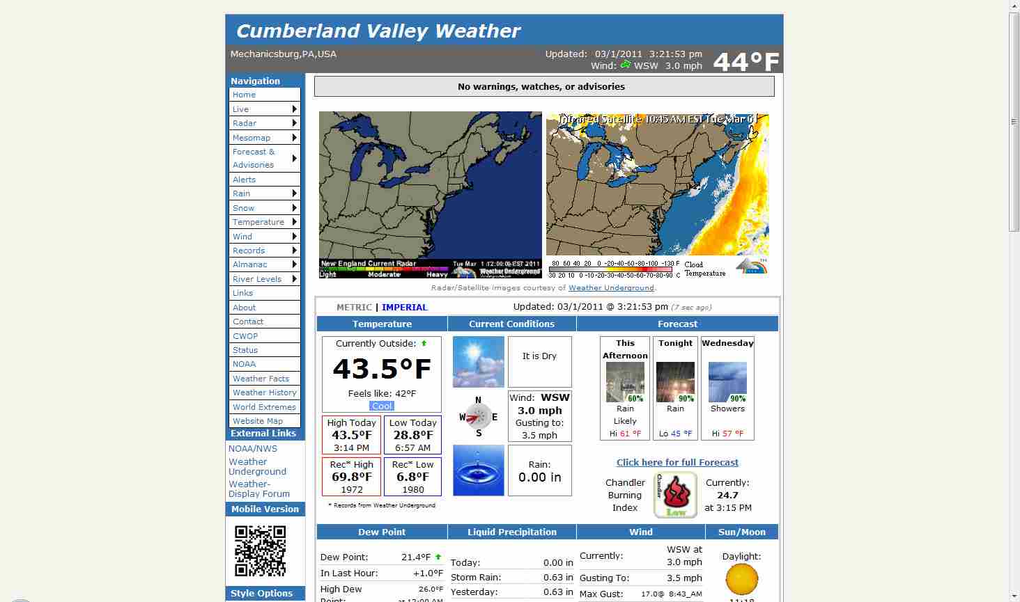

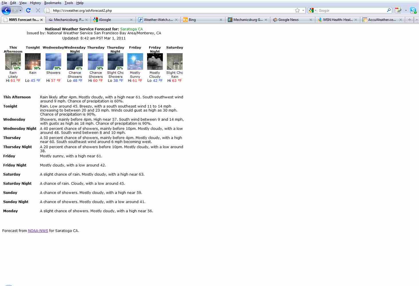

While attempting to setup forecast-compare-include script WXSIM vs NWS, I noticed my main page had the NWS forecast for Saratoga CA. I thpught this was configured in the template settings, my setting was ok there. Next I checked the advforecast2.php script and it did indeed have the original NOAA code (advforecast2.php)
So I changed that and uploaded, stlll geting the Saratoga NWS forecast, what did I miss.
The advforecast2.php script uses the Settings.php values only when it is included in a template page. Since you’re using the script inside the forecast-compare script, the settings for your point-printable URL and zone need to be in the advforecast2.php script itself.
Try using ?force=1 after you’ve configured advforecast2.php, and you should see your local forecast instead of the Saratoga forecast … you’re probably just looking at the cached version (which has a 30 minute lifespan).
Ken
Thanks Ken,
I had never changed the advforecast2.php script. I thought it only needed to be in settings… :frowning:
Correct, no customization needed IF included in a wx…php page, otherwise, the internal settings in advforecast2.php are used. Same result for any of the support scripts supplied with the template sets.
