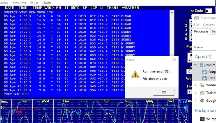

Run-time error 55 - file already open
HI, i keep getting this error, for the last few days, i am now trying a manual run and i am still getting it, i cannot figure out what is going on, any ideas please?
I have figured out that the error comes about every time the program exits be it automatically after a run or manually “exit” from the file menu.
There are no other screens open, nothing in task manager and it will also appear even if i open the program and ty to close it straight away
without any other activity.
I am running the latest version as i tried an upgrade yesterday and i still get the error, also you can imagine that auto running now is not possible because of it.
I have tried changing alreadyopen to 0, same error, one is at a loss now.

Hey BMX,
I’ve been fighting this same error in WxSim for 2 weeks and have finally resolved it. Here’s what I’d recommend to get you started in finding the problem.
Make sure WxSim, WxSimate, and WxSim-Lite are all closed.
Open each of the following files and make sure they contain a ‘0’ in the first position of the file and nothing else. If you see a ‘1’, change it to a ‘0’ and save the file.
wxsimateopen.txt
alreadyopen.txt
autoret.txt
wretopen.txt
wxsimopen.txt
gfsmissing.txt
locmissing.txt
Also, review ecdata.txt. This file should contain several lines of data. If it contains a series of NUL characters in row 1, this file is bad and you’ll need to restore a good version of this file. This ecdata.txt file is the one that was causing my WxSim not to shut down cleanly until I restored a good copy.
Hope this helps you.
Steve
Thanks ever so much Steve, it looks like it was 3 files, 2 had a 1 in them even though i had only just changed 1 of them a few days ago, and ecdata was empty 8O so i have a feeling that was at the bottom of it all, i have done an auto run and it all closed ok, i will know for sure later on this morning after a timed auto run and will report back then, thanks again
