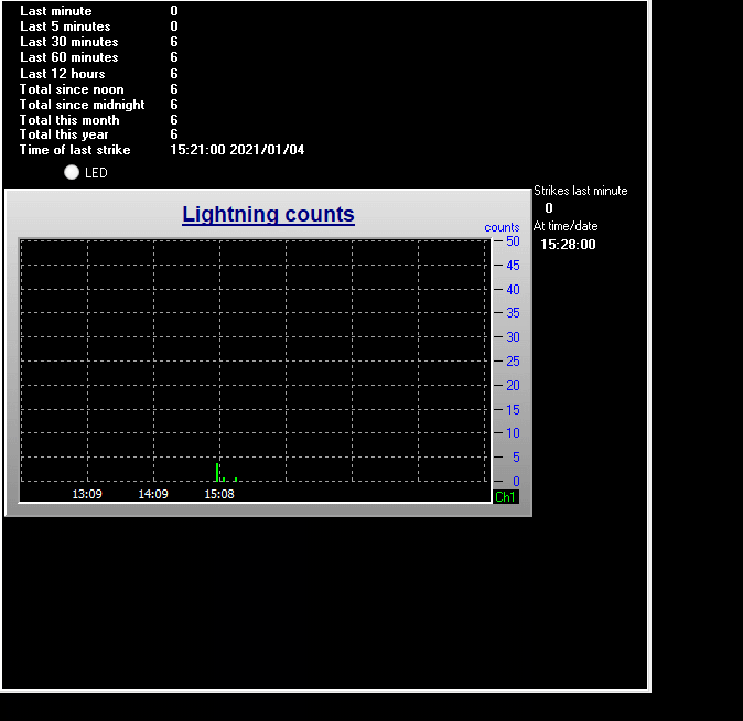

its to do with the last strike time shown on the lightning page of WD if i reset all, the error stops till the next strike this was doing it in build 120 pre new compiler

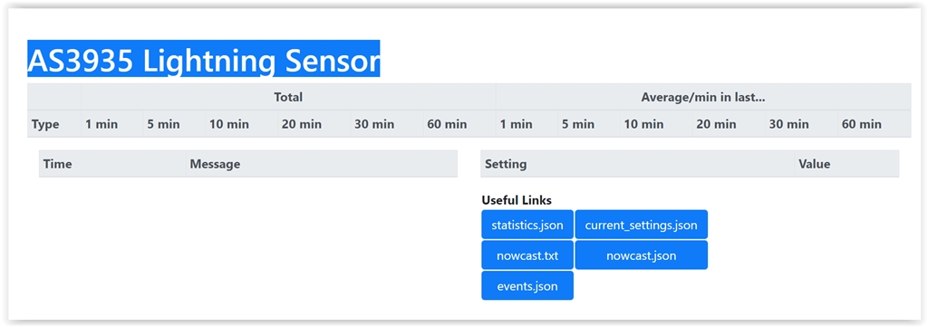

I’m not sure if mine is working anymore even after rebooting it. It says the service is running but here’s what is on the http page. I do get values shown on the ‘Useful Links’:

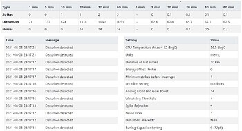

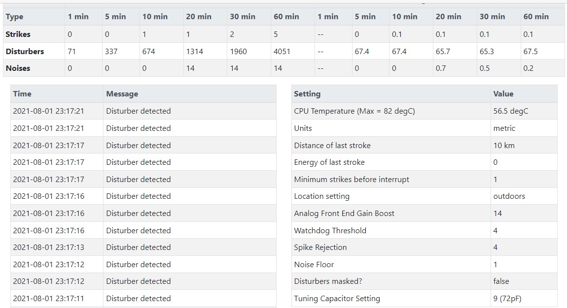

had some lightning in my area last week but the pi failed to see it just disturbers and noise yet i looked while it was happening
i get sporadic false strikes the attached taken a short time ago shows false strikes but not seen and lightning or heard any thunder
