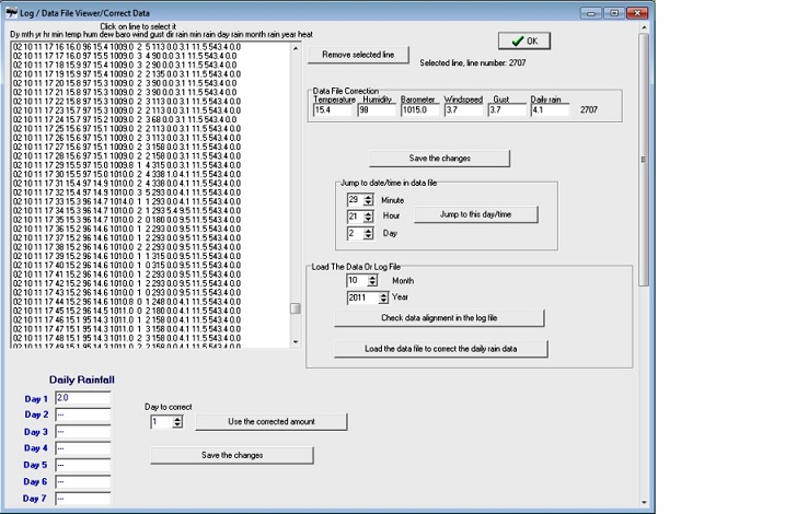

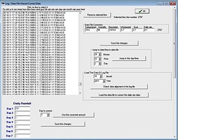

I recently upgraded to the new build 80 today and after rebooting and starting WD again, the actual rain today had more than doubled from 4.1mm to 9.5 mm.[/u] I had to manually amend this back to 4.1 mm and have since reloaded the older build 75 and all is working fine. Is there anyone else with this problem? I am running Win 7 pro 64 bit with an Oregon WMR 200.
I have not changed anything with the rain values routines/code from the wmr200

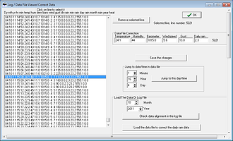

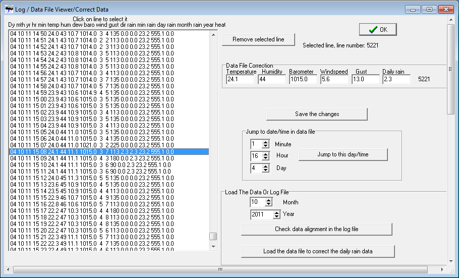

Hi Brian, I am running build 80 and rebooted today and rain to the value of 2.3 mm was added in after starting WD even though we had no rain.I have had to delete this entry from rain offsets and placing 0mm in for the day to correct this. Any ideas?
was there rain in the wmr200 history data that was imported?
Hi Brian, sorry been away for a couple of days. No there was no rain in the history data at all. I have now collected the Davis VP2 Plus and will be setting it up in the next week or so.
