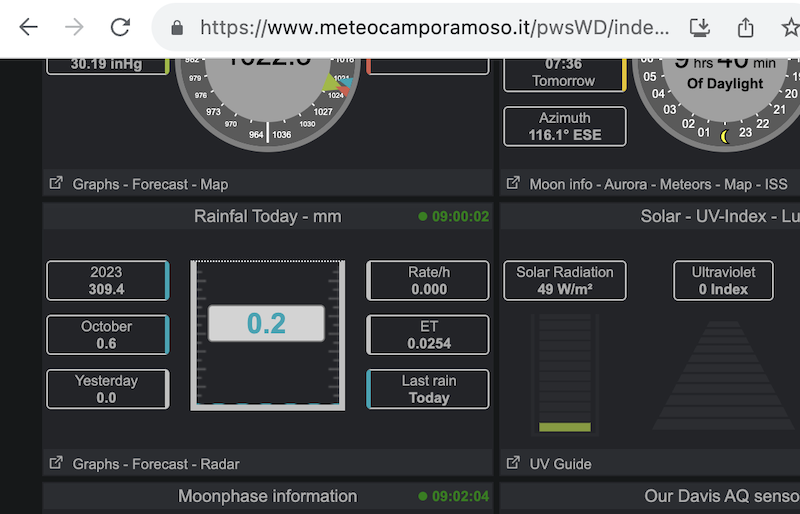

Sorry for opening this post, I used the search option but couldn’t find the solution. I have noticed for some time that on my site in the rain box, the date of the last rainfall is fixed at January 25th. How can I solve it?

Your cron-job is notdoing it job.
The items in the history file are old.
https://www.meteocamporamoso.it/pwsWD/PWS_listfile.php?file=_my_settings/history.txt&type=arr
These are the latest midnight runs:
[last_roll_over] => 1674946509
[last_roll_over2] => 2023-01-28T23:55:09+01:00
[last_first_day] => 1672527309
[last_first_day2] => 2022-12-31T23:55:09+01:00
[last_rained] => 1674686340
It seems there was no correct cron-job at midnight since 2023-01-28

Thanks to both of you for your help. In fact the CronStation was disabled; we see that due to the internet on January 29th the cronjob failed several times and therefore it was disabled. For the graphs, I followed the guide but I don’t know if I solved it

Thanks for the reply. I did as you told me but I don’t think I solved it
Did it rain yesterday or the day before?
Last rain can only be updated when it rains on a day.
Also run easyweather and do a save (green button) as i am confused that you say www.meteocamporamoso.it but the website is at www.meteocamporamoso.it**/pwsWD/**
Yes, the graphs are OK now
url of my site is like this for one of my settings. No it didn’t rain but it should rain next week
The station measured rain and the data in the history is adjusted with the last time it registered rain.

[last_rained] => 1697168098
Yes, everything is working correctly
