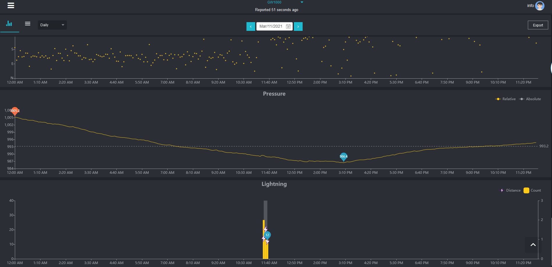

How/where to enable Ecowitt? As I upload my data also to Ecowitt, the last lightning was recorded March 11 an 11:30AM .
Nice to see also here in historical data at 11:30… Blitze & Gewitter - Historische Blitzkarten
However, did not found any options in easyweathersetup.php now…???

The data from an ecowitt station comes from custom upload. Not from the Ecowitt website.
Your data “./jsondata/ecco_lcl.x23qs34s” has for lightning
    [lightning_time] =>
    [lightning_num] => 0
    [lightning] =>
The last lightning data is lost when you install new firmware, which you did: GW1000A_V1.6.6
There is request at Ecowitt to save the data when installing new firmware, same as the rain-data is saved.
As soon as there is lightning data it will be displayed in the lightning_station_small.php block.
