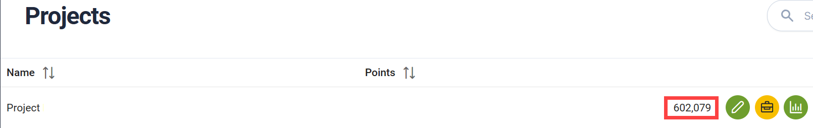

Nope, I have over 602,000 left
Left where? In your Organization or your Project?
Whatever, it seems PAir doesn’t recognise your API key. . .
In my project. My API key hasn’t changed nor have I changed any PWS settings.
