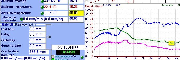

"Prophetic" minimum temperature
For a few days, the time of the minimum temperature has stuck at 1845. The attached will show this, over 8 hours before 1845!!! The recorded temp of 7.4

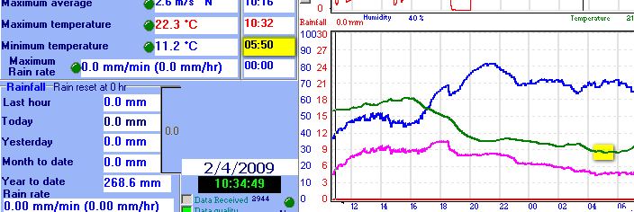

OK, thanks. I’ve altered the 18:45 to 05:50 in the INI file. On restarting, it has displayed it correctly. I’ll have to wait until tomorrow to see whether it reverts, stays at 05:50 or displays the correct new time. There was no apparent reason visible in the INI file.

It HAS stuck at 05:50: today’s minimum was nearly an hour later but it still says 05:50, which is in the INI file. What is the mechanism whereby this is calculated and the correct value inserted? What can I do to correct this anomaly?

the temperature has to beat that miniumum for a new time to posted
Thanks for the reply, Brian, but I think that I may not have made myself clear. The time displayed is always (every day) 05:50, no matter when the minimum temp occurred. The min temp is always correct, it is just the time that is wrong. Last night, for example, the min temp was 11.2

Below is the proof that today’s min, at 11.2
