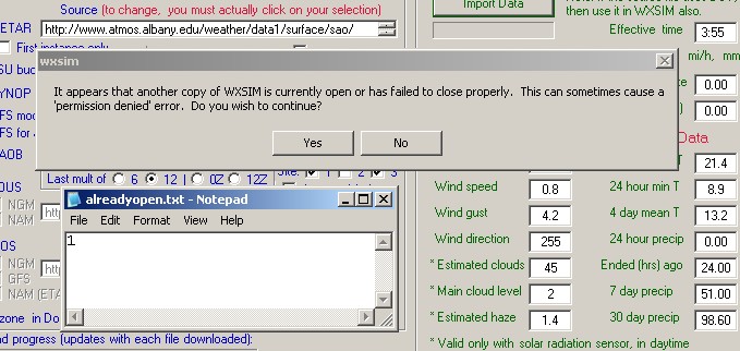

I tried yet another test overnight with my system to make absolutely sure about the “alreadyopen.txt” file and the error caption.
With the error caption showing on screen(anothy copy still open etc…blah…do you want to continue? yes/no boxes)…the alreadyopen.txt file is definitely showing as being a “0”.
So far, I have not seen the error. The only difference in my set up is that wxsimate is running constantly and I have just 1 task repeating, every hour, the opening of wxsim. Previously I had 3 separate tasks running at 6am, 1pm and 7pm to start wxsim. I’m not going to change anything just yet, but I would have expected to see the fault appear by now !?
I got the error on my 15:00 forecast run today.
alreadyopen.txt had a ‘1’ in it when I looked and yet there was only one WXSim open.

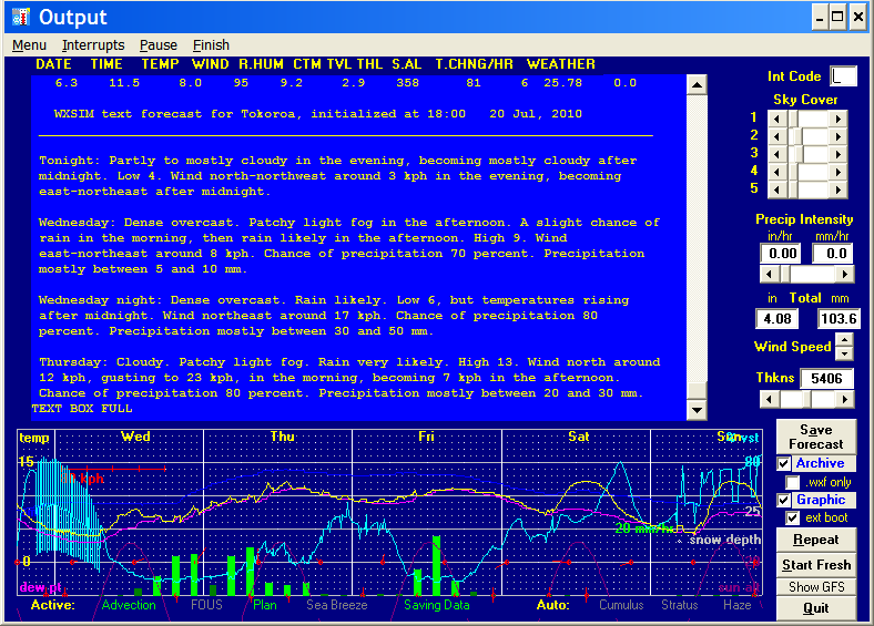

I have seen some strange graphs being produced with vst I think going up and down rapidly, I have an image of it attached here. It was still a complete and valid run but…
Added the wxf file too… as a txt
f10072018B.txt (125 KB)
<<I have seen some strange graphs being produced with vst I think going up and down rapidly, I have an image of it attached here. It was still a complete and valid run but…
I’ve seen this sort of thing with auto cumulus and auto stratus, and perhaps with the sea breeze, but it doesn’t look (from the text at the bottom of the screen) like those are checked (please confirm).
Another thing to check: your output interval and iterations per interval. I think a good choice is 30 minute output with about 6 iterations per interval (these are under parameters). Sometimes if the interval is too big (or not enough iterations per interval), things can get “choppy” like that.
Yes, auto-cumulus amd auto-stratus were checked… but I have also set the iterative to 6 times from 3 so that should make a difference. :slight_smile:
Graeme
Tom for the first time ever I have had a problem with the alreadyopen.txt file containing a 1 when no WXSim was running. It had failed I think this morning at the 07:40 run and probably because of the error message I get when I try to start it manually. It says that the stored water temp differs from climatological norm by more than 4.5 degF or 2.5 degC please visit Diurnal Breeze and click yes. Now the water surface temp showing is 15.5 degC and the actual at present shown by a buoy in the Channel is 17.2 degC. I get this message everytime I try to open WXSim. The current value I had was 15.5 degC which is a bit low. Having reset this to 17.2 it now has gone away.
I believe I mentioned before that the actual temp is available from a buoy and it would be good if WXSimate could retrieve the current value and use it which would save this error happening if I use a user entered value which seems to override the WXSim climatological value.
Edit:
I’ve been thinking about why the alreadyopen.txt file contained a 1 in this case and I believe that when the system scheduler closed WXSim after it was still running after some hours it does not shut down correctly because of the outstanding message. I just wonder whether this could be happening to others, that is an outstanding message stopping the program closing properly. If this message is a transient error condition (unlike mine which happened on every program start) you would be unlikely to see it when you came to start the program again but the alreadyopen.txt stops it because of the 1 value. I dont know if there is any way for Tom to trap a close like this when there is an outstanding message and close normally zeroing the alreadyopen.txt, if not I suggest this is a potential problem and maybe another way of determining another copy running should be investigated.
