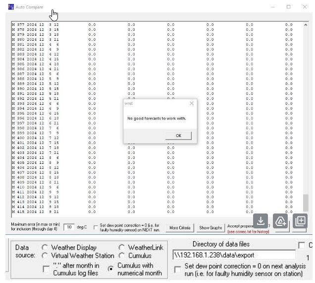

I have not noticed any issues, but anyway I installed your first fix wret 1.1 on the 12th Dec and it caused my entire wsxim suite to be quarantined by my security software (never ever had that before). So reverted to wret 1.0 and un-quarantined wxsim suite. All ran fine again.
Then on the yesterday I installed your latest version wret 1.1 and had no security issues, however overnight at 01:00 when I always run Autolearn it failed to complete (complaing it could not find the yyyymmlog.txt files.
Wret version 1.0 was already finding and processing them, so I had to revert back to wret 1.0 again and now it runs fine, well aside from the un-known possible error as mentioned earlier (I am still unsure where to look for that)?

the same thing happened to me too
Hi Norbert,
Yep I also had that same result too, because it could not find the cumulusmx data logs…

It just fails every time for me and Norbert.
