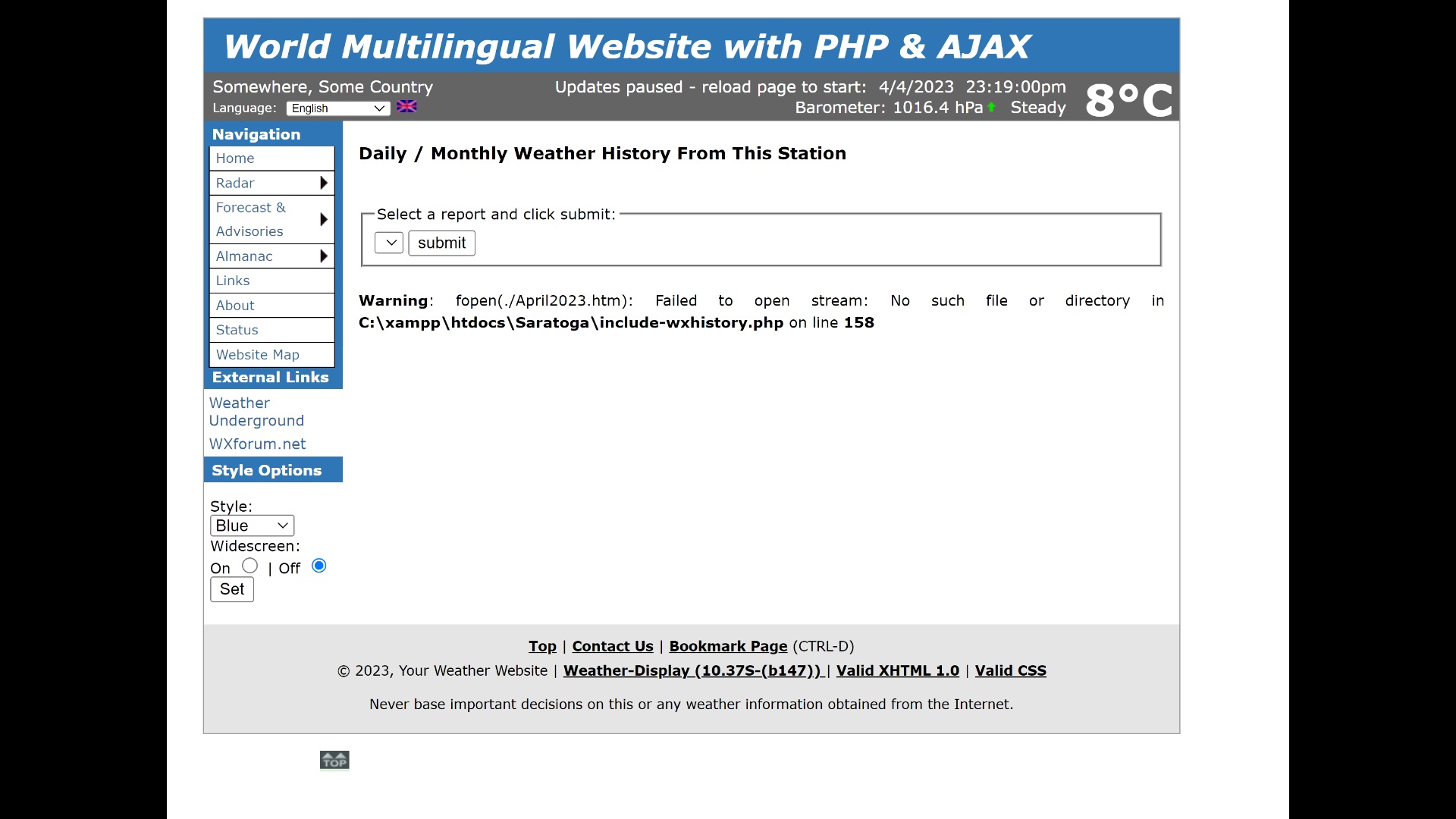

Hello. I configured WD with Saratoga, it works but not everything is fully configured. The thing I would like to fix first is the department - Station Montly Record - in Saratoga that when I click it gives me this errrore: \Saratoga\include-wxhistory.php on line 158. What should I do? Do you want to write something on that line or activate something in WD that I didn’t activate? Also missing some trend where Saratoga gives me this error: Saratoga\WD-trends-inc.php online 709. Also in WD I have a database that starts from 2014 can I transfer all the history in Saratoga?

I’m really inexperienced, and before buying a hosting I’m testing Saratoga in localhost with Xampp. I don’t know can send a screenshot.

Depending on how long you’ve been running WD, the daily history file is only produced once a day just after midnight local time. You may have a copy of it in the c:\wdisplay\webfiles directory you could manually copy to the c:\xampp\htdocs . You have to make sure you’ve set up WD to generate and upload the needed files to the XAMPP htdocs directory routinely. You can run the XAMPP FTP server to receive the upload files from WD and put them in the htdocs directory. Then, when you move to a public site, it will be a matter of file uploads, and redirecting the FTP to the public site.
Use: Saratoga-Weather.org - Website Templates - AJAX/PHP - Weather-Display Setup to check your WD settings.

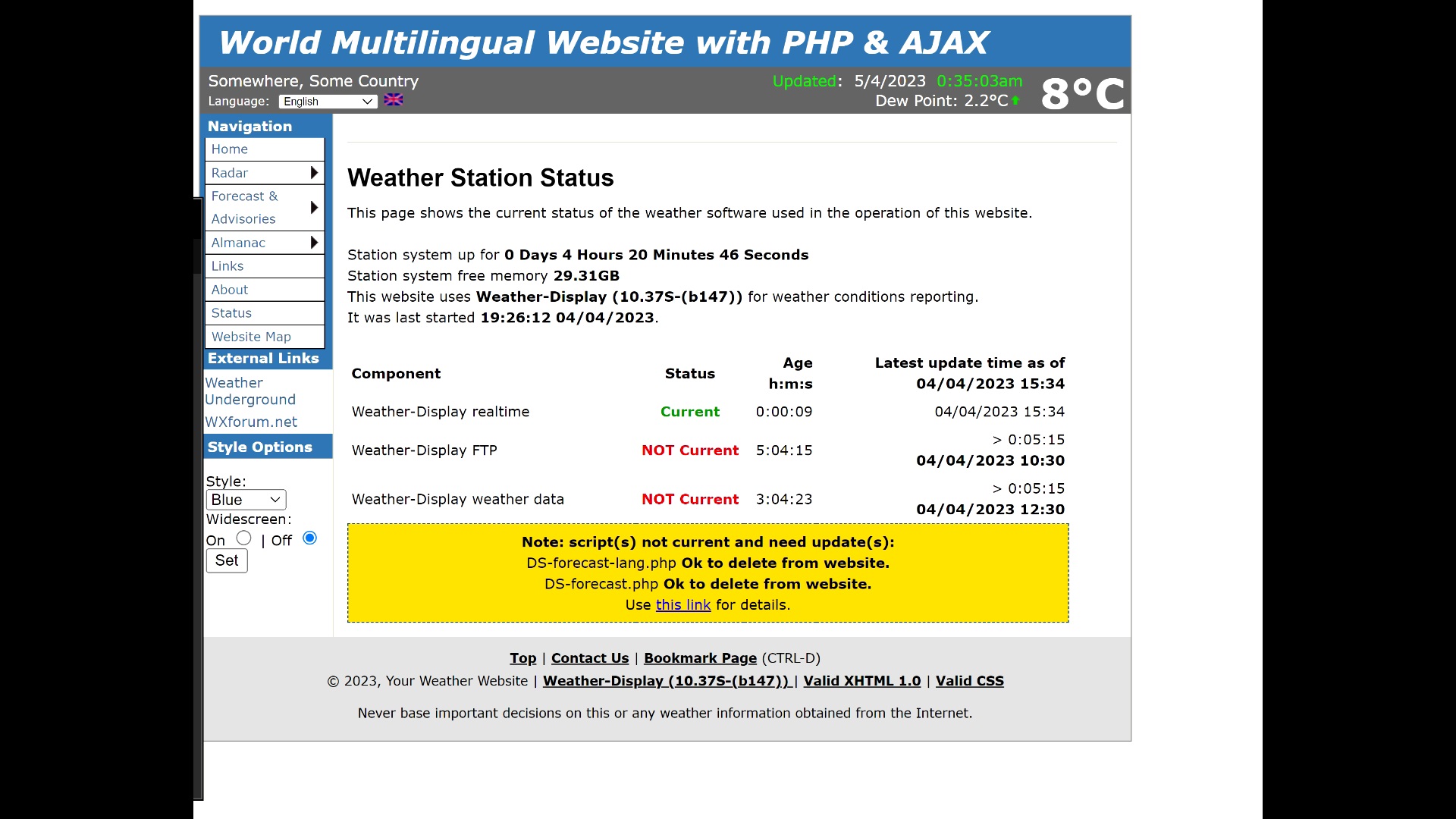

The file to copy in WD (dailyhistory) and paste to the xampp-specific folder is -dailynoareport? I see only that. Is it .html or txt? I also send this screeshoot.
I also understand that WD is only sending in real-time. But I have carried out the instructions to the letter from the site that you linked to me. I’m double-checking but they seem fine. I’m enjoying it anyway. Thanks for your help.
