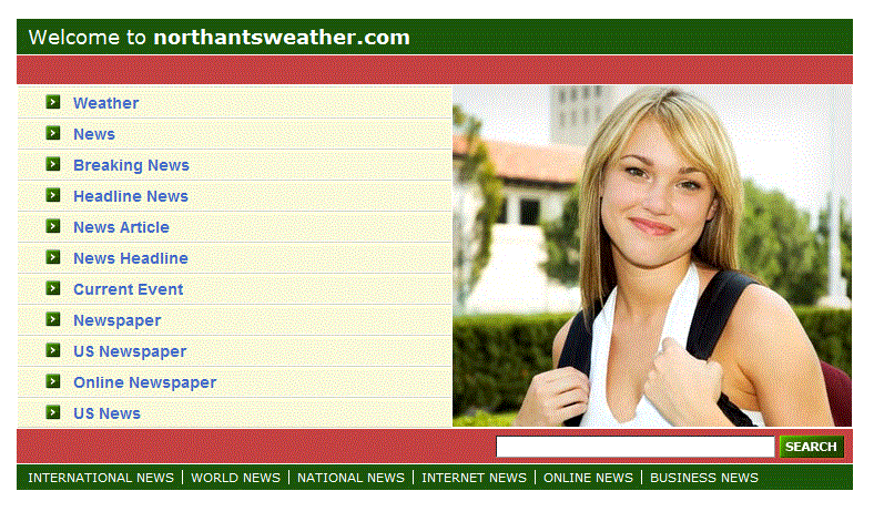

Simon… see attached
Where do you see that?
When you go to your page, thats what it shows. try clearing your temp internet files and cookies then you should see it too.
Oh poo, thanks guys, i didnt get a warning email about it, best try to fix that quick lol
Whoa, that’s bad 8O
isnt it once a site is parked, its easier to get a new domain than to get the old one back? Hopefully thats not the case for Simon.
