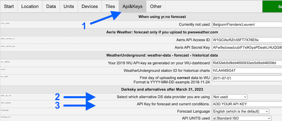

Please enter the texts as in the screenshot in PWS_easyweathersetup.php
That should solve it.
If you want to use Openweather data, you have to obtain correct Api-keys a.s.o.

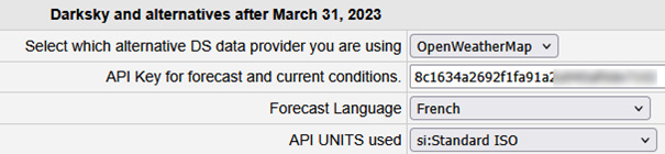

Hi Wim,
Thank you very much for this analysis, it’s appreciated!
In my settings EasyWeatherSetup, I correctly entered the API and selected OpenWeatherMap (I’ll send you my password if you’d like to take a look)
On OpenWeatherMap, I have 3 APIs with a free plan.
To test the 401 error, I went to the OpenWeatherMap site to test the following 3 requests with the 3 APIs I have available:
https://api.openweathermap.org/data/2.5/weather?lat={lat}&lon={lon}&appid={API key}
The result is OK for all 3 APIs.

Open Weather map needs the 3.0 API key since a few months.
Thew 2.5 is no longer active.
