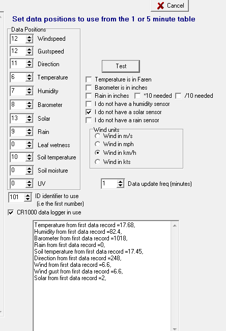

I found out that when i chose Solar on position 13 it works ok!!

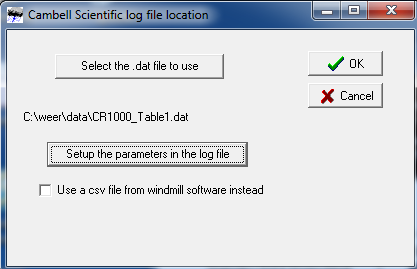

are you using the windmill log option?
No, i don’t use a windmill log.

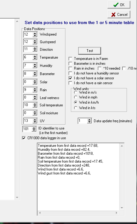

it should work OK using the UV set to 13
setting the solar to 13 will just make the solar be the uv
when you say the UV was not working, how are you basing that?
I set the uv-sensor to 13 (see picture).
But when i press the “test” button the uv-reading not appears in the list a the bottom of the picture.
that does not mean its not working
just means I had not added UV to the test output
you should be able to see the UV reading i.e via a UV custom tag
or set to plot on the main screen graph
and the value should show on the main screen, above the wind speed dial
