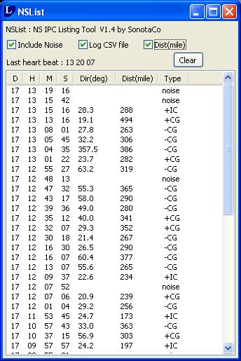

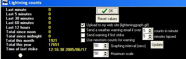

Not seeing anything here for data.
so you have had strikes in the last hour?
Yes.
…past 60 minutes…http://weather.dcrooks.net/NexStorm/StormVue.html
…past 30 minutes…http://weather.dcrooks.net/wx5.html

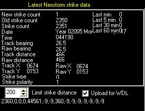

edit: Is WD limiting the data to the range set, or should it register everything?
Ok, working now. Yes, it is using the limit distance for strike data.
