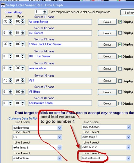

Please see the first image
Leaf wetness is set on channel #4
I’m not getting any reading for the leaf wetness tag %vpleaf%
Image number two
Setup extra sensor real-time graph
Leaf wetness only goes up to number three 3

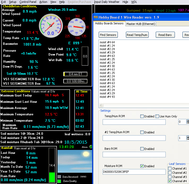

Image number three
On start-up of the new hb1 wire reader
All the wet leaf channels are always ticked
Hope the images help with any confusion
Thank you
I just tested here and I can have only #4 leaf ticked
make sure to click on set…to the right of that

I will look into adding option to plot leaf 4 in a future update

Please see image
I’ve used the %VPleaf4% Tag in the main window customised setup which displays this on the main display
