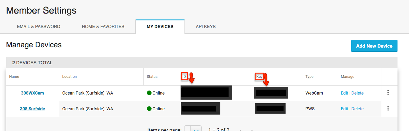

The login credentials for your wx station and webcam are as shown in the attached image (blacked out of course).
Do not use the same credentials you use to login to the WU site with your browser. Each device now has it’s own login credentials.

Login to WU and copy down your ID (username) and Key (password) from My Devices for your webcam, then put them in as shown in the attached.

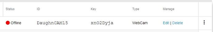

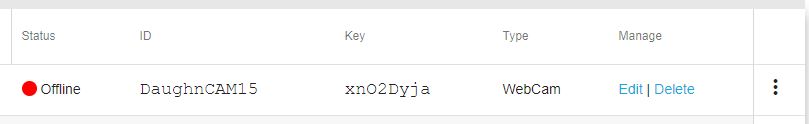

Maybe I shouldn’t post this, but need the help. See below to the Capture.jpg

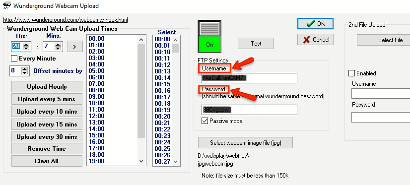

In the wugrab2, what do I put in for the FTP username and password? Those entries I am not sure of. It says to enter the WU password but that probably isn’t the one I signed into my WU account, right? It says to do that however, but it doesn’t work.
From your screen grab you have the necessary credentials for sending WU an webcam image. As shown in my earlier screen grabs (https://www.weather-watch.com/smf/index.php?action=dlattach;topic=69044.0;attach=69595), you would enter DaughnCAM15 as your Username and xnO2Dyja for password in the WD setup screen as shown.
Note on that same screen grab under → Select Webcam Image File [jpg] ← you will see the file I have selected on my D: to be sent to WU. I have WD managing my webcam image but you could have another “source” producing a local image captured from your webcam, just click that Select button and “point” to the image you want to send. Remember there is a 150K file size limit.

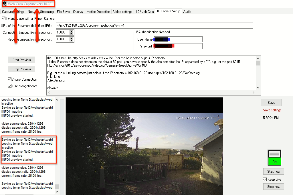

Where do I find this WD screen with tabs? I have looked everywhere on WD and still cannot locate this page of yours.
that is a screen shot of the separate running wdwebcamcapture.exe program
