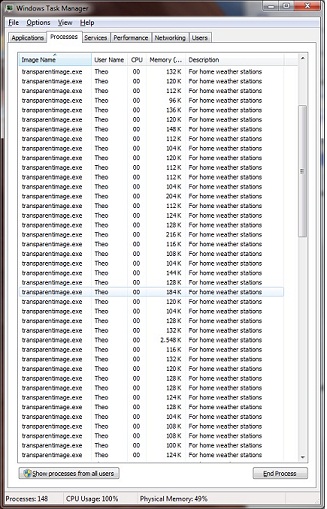

Few years ago there was a memory leak with the use of the transparent images.
It looks like that memory leak is back. After 24 hours of use of WD, i have about 20 (or more) processes of transparentimages.exe running on my pc.
Is this a known problem?

pc: OS = Windows 7
Weatherstation = LaCrosse 3600
WD version = 10.370 built 18
Regards
Theo

I’ve also got multiple transparentimage.exe instances running. I recently had an issue with an animated image I was using on the main screen so I may have changed something, while troubleshooting, to cause this issue.

After enacting the changes Theoh suggested, still having multiple instances of transparentimage.exe spawned.
Computer has been rebooted several times over the past few days… TIck changes did “stick” so both mentioned in Theoh’s mail have been de-ticked…Yet 20+ instances running…
Windows XP - Service pack3 with current updates. Wdisplay build 10.37o Build 24.
