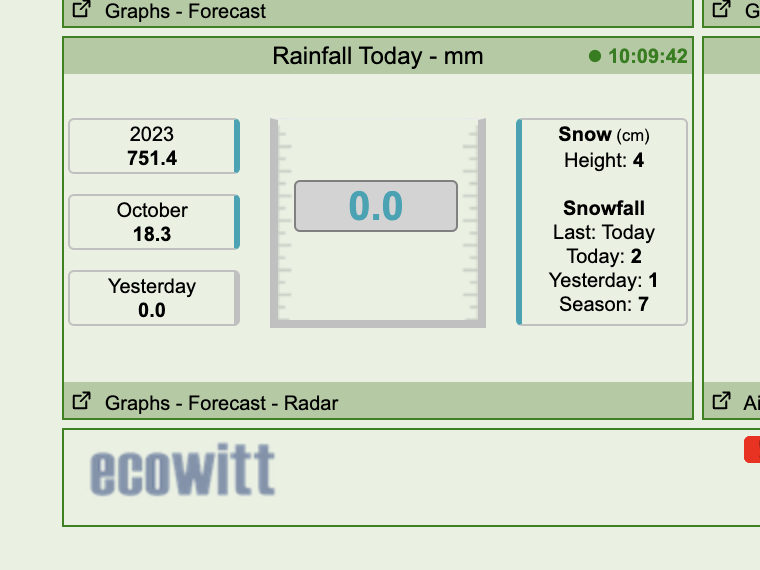

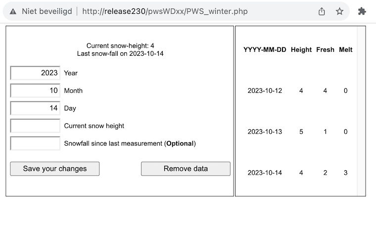

You can use PWS_winter.php to manually enter snow-heights.
The snow-height is only shown in the “rainfall”-block if there is a positive snow-height value
and
if the outside-temperature is less then 5°C

Hi Pgee,
The HTTP error 500 is a script-PHP error
You are using PHP 8.1.23 which can not be the problem.
Please test with
https://carstairs-weather.ca/pwsWD/_test.php?test=PWS_winter.php
Maybe that will give a clue.
Did the error occur after you entered any values?
Did the values show up after you restarted the PWS_winter script?
Could be a file permission problem?
Add this 1 line file to your ./jsondata/ folder
snow.txt (31 Bytes)
Otherwise I have to check myself what is going wrong on your website
For that I need your easyweather-setup password.
Do not post the password here, but sent a PM or a mail.
