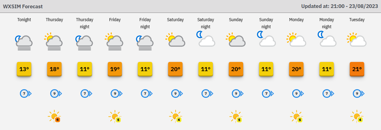

McMahon 2pm forecast
I’ve had this before…
Wind speed 4mph, gusting to 38mph.
Where is this 38mph coming from?
The whole forecast is pretty lame. It has it cloudy, yet it’s blue sky.

Still getting this problem. Earlier today, wind forecast was 9mph, gusting to 34mph. This evening, 8mph, gusting to 31mph.
The forecast winds for Thursday look to be higher. WXSIM showing winds at 17mph, gusting to 30. So how can it be showing such high gust values during lighter winds?
Another big problem with the gust forecasts from WXSIM, is that is greatly under reads values when high winds are forecast - 40 mph=.
There’s been numerous times where 50mph+ gusts have been forecast by the Met Office (and I usually hit those values on my anemometer) and WXSIM has only shown 30 to 35mph.
On the flipside, WXSIM will greatly exaggerate average wind speeds when 40 to 50mph is forecast. I remember on many occasions that WXSIM was showing 35 to 40mph average wind speeds. Those sorts of speeds are rare as hens teeth here, and if they did occur, gusts would be in excess of 60mph. I know this due to my data, and what the Met Office will forecast. Even if the Met Office are showing gusts to be in the mid-50’s, wind speeds are circa 30mph, and it’s usually spot on.
