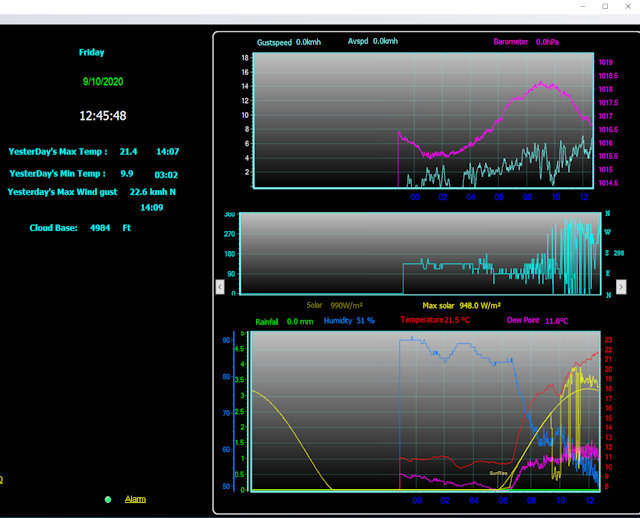

When I logged on to WD this afternoon, data downloaded from Davis VP2 data / display unit and WD display updated but graph display failed to show data prior to midnight. - see attached image 2.
Graph did display all data when viewed yesterday [ 8th of month ]

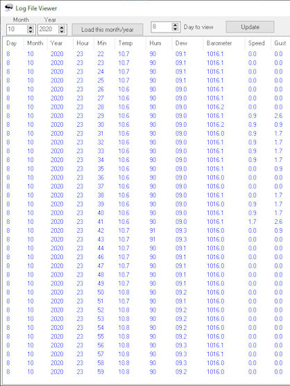

Checking log file viewer [ image 6 ] data for period before midnight [ 8th ] is shown to be available

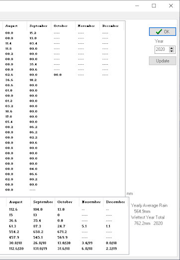

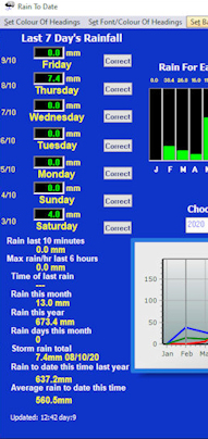

on checking other displays, detailed rain chart for October [ image 3 ] shows no rain for first eight days and correct 0.0 for today [9th], however image 1 - rain to date - shows rainfall on 3rd and 7th with a total of 13.0 mm for month. The daily figures did display on detailed rain chart yesterday for all days recorded this month…
