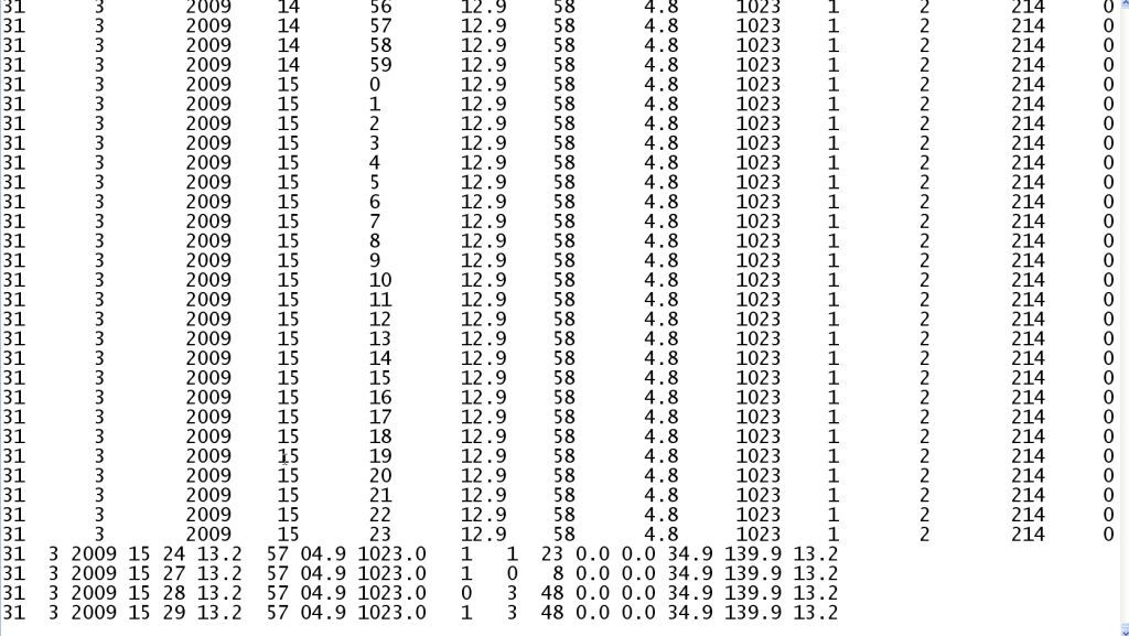

Hmm… Similar thing happened to me today:
As usual (every day), after my WMR200 data was extracted, I saw on the graph that the temp., RH, And DP lines had dipped sharply in the minute after the history extraction was complete, so I corrected the 32009lg.txt file, converted to graph data in WD, and re-created the last 31 days of data.
Every time I have done this prior to today, the graph lines smooth out and all is fine.
Today however, all the graph data since around 2300 yesterday was erased. I frantically searched the 32009lg.txt file but all was fine here, so I looked at the graph file (.inf) to find that the data was indeed missing. I tried repeating the convert log to graph and re-create procedure, only to find that once again this deleted all recent graph data since ~2300 (thankfully only about 10 mins this time since most of it was already gone forever).
The attached screenshot should aid this explanation (note time change from 22 to 217 to 18 and double grey vertical line on wind graphs where the data discontinuity occurs).
Any ideas on what is going wrong would be much appreciated.

It is getting near the end of the month - check the log file to make sure you do not have more than 44640 lines of data. Anything more than this will not be processed by WD. If this is the case you will find the log file has a lot of duplicate lines that will need to be removed. I use the sort and filter capabilities of excel for this purpose. But the WD logfile bug finder/checker program that can be found through the forum may also be able to do this?
If this was your issue, once the excess lines are removed convert the file as normal and all should be fine.
The duplicate lines seem to occur if you download from the WMR200 console memory a lot rather then record live data and if there console time, date and timezones are not kept exactly the same.
Well I checked and I think you’ve identified the issue, so thank you.
32009lg.txt has 46055 lines as of 2142 today,
The graph file is on 44503.
So by the end of tomorrow there’ll be around 3000 lines too many in the lg.txt file.

I did all this and the excel filter trick worked perfectly, but when I loaded up WD and converted the new log file (tab delimited) to graph data the graphs went haywire. As WD started logging, I could see from the log file that its entries had a different set up from the entries produced by the excel conversion, which is probably the problem [see attached screen shots].
How do you get around this problem?
Timmead
EDIT: Now WD has decided not to do the monthly rain reset on the logs, and is not even converting my new April log to April graph file, I really need to know how to get this to work!
