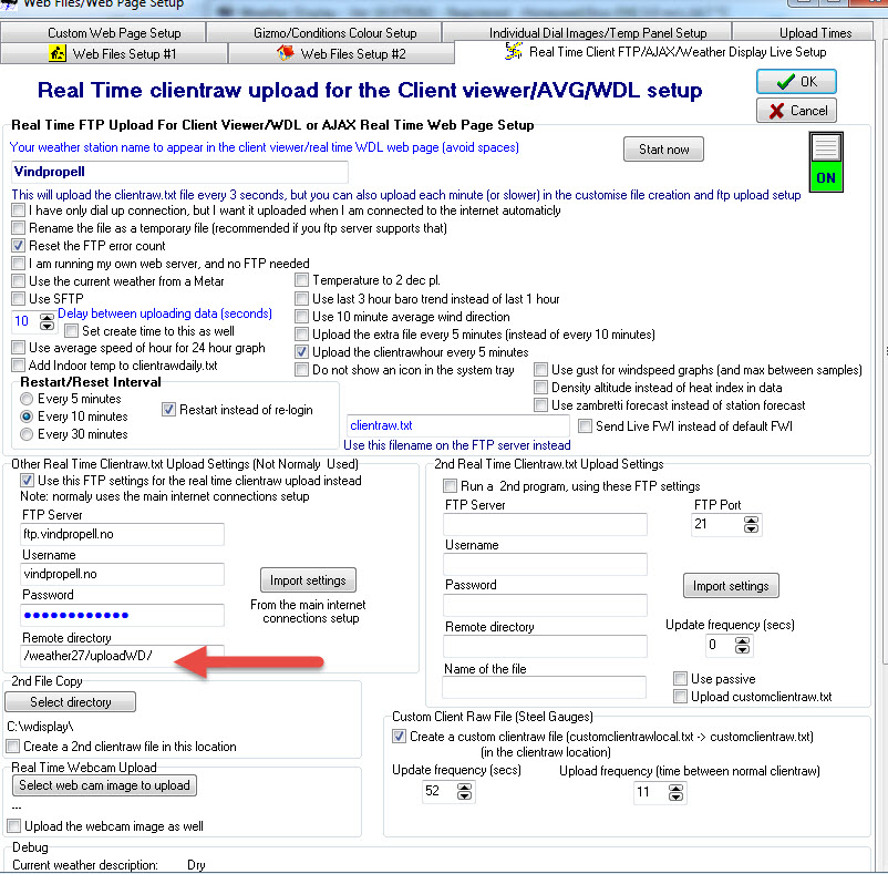

I need to ask this question:
If the default upload folder is set to /weather27/uploadWD/ in wsUserSettings.php,
will the settings in WD look like this?
See red arrow in picture.
Pretty much, only one way to find out, might need to experiment with the /'s
Are you kiddi
[quote author=tobydude link=topic=60621.msg483479#msg483479 date=1432904795]
Are you kiddi
Ok. Not to wonder I never got the clientraw files to upload to /weather2/upload, but had to use the root as uplad folder.
Then this setting in WD (in the picture)n has to relate to version 2,6 also?
If you are now uploading to the root, or to whatever folder, you should leave it as is.
WD is such a big program with so much possibillities that you should not change it just for a new release.
