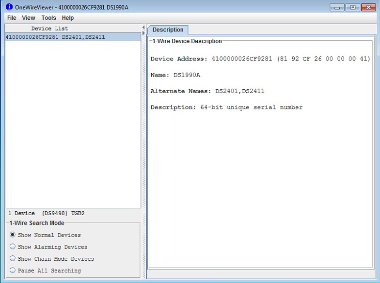

Hi again
Very strange… my 1-wire lightning detector can not be found anymore. I had it working for about a week- and now it has dissapeared.
See attached pic.
I have tried uninstalling and installing the drivers and removed the USB files from WD folder - but no luck :frowning:
64bit is a real pain in the a…
Anyone have a suggestion what to do?
